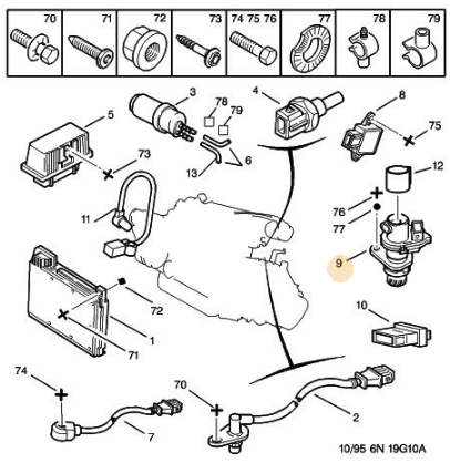

Where to locate the flywheel sensor and crankshaft sensor on the Peugeot 605. I can not find these.

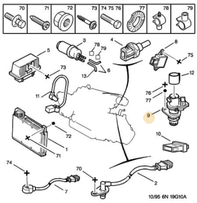

The only valid VIN is the one ending in 832 - the last one is not valid. So this one is the
605 4 DOOR SALOON 2.0 i 8v TE Auto gearbox 4 with XU10J2TE engine.
Information is limited I'm afraid, but hopefully the following diagram, although not detailed may help you identify the location of the sensors:
| (4) - Water Temp Sensor |
| (8) - Acceleration Potentiometer |
| (9) - Speed Sensor (2 way) |
| (10) - Speed Control Housing |
| (2) - Engine Speed Sensor |
| (7) - Engine Pinking Sensor |
| (11) - Intake Air Temp Probe |
