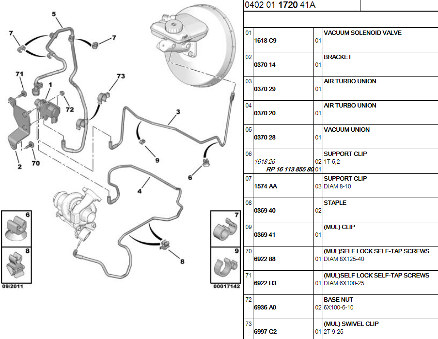

Only the turbo is vac on this engine. P0240 will be causing limp. On a 110 it could be the solenoid, vent filter, or turbo vanes, not sure about the 90s

This is the BERLINGO VU (M59) SHORT VAN '600' 1.6 HDi 75 Manual gearbox 5
So the HDI 75 engine.
You didn't mention code P0240?
So here's the Turbo Vacuum circuit to check - part 1 is the solenoid:
Click to Zoom Diagram

Mis read it, I meant P0234 - it's the overboost one anyway!

Soon as I hit 60mph or over 3k revs it looses power new injectors and new turbo checked the vaines clear so going to change the solonoid and see if that's helps
