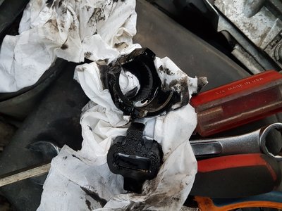

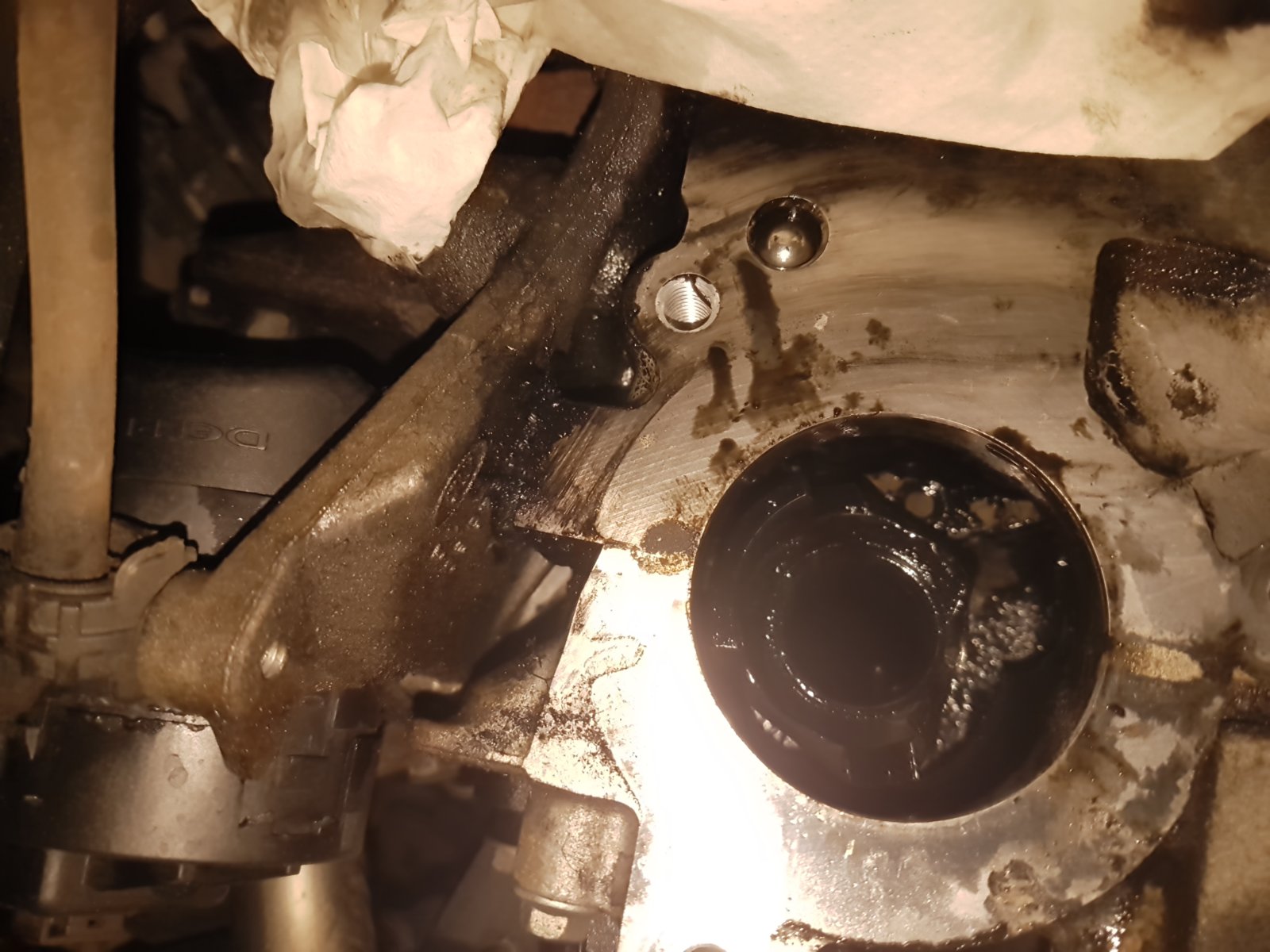

Not good news.
Disconnecting the sensor resulted in a pressure of around 390 bar reading when cranking. Reconnecting brought a steady zero.
Primer pumps fuel through return line into a jamjar, cranking does not. Leads me to believe it's the hp pump. I popped that off, and the bad news showed. Theres supposed to be a yoke on the end of the camshaft with a joint inside around the pump shaft. That yoke is broken off. I'll need to get the rocker cover off to look for all the bits.
How much of a ball ache is it to change the exhaust camshaft ? Is it worth it ? Any ideas where to get one ? So many questions.

Re: 307 2.0 HDi RHR 136 wont run - no fuel pressure
Pump rotates readily by hand, so isn't seized. No real reason for this yoke to snap off.
