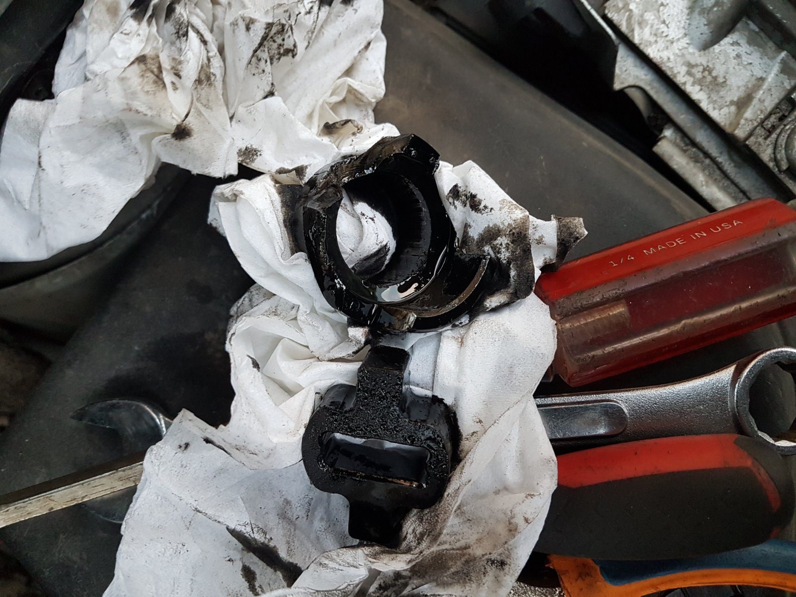

Primer pumps fuel through return line into a jamjar, cranking does not. Leads me to believe it's the hp pump. I popped that off, and the bad news showed. Theres supposed to be a yoke on the end of the camshaft with a joint inside around the pump shaft. That yoke is broken off. I'll need to get the rocker cover off to look for all the bits.
How much of a ball ache is it to change the exhaust camshaft ? Is it worth it ? Any ideas where to get one ? So many questions.

Pump rotates readily by hand, so isn't seized. No real reason for this yoke to snap off.

Bugger....! Book time is 7 hours, and involves removing the injectors, so not going to be a walk in the park! Be just as easy to find another engine....

Re: 307 2.0 HDi RHR 136 wont run - no fuel pressure
Just thinking. I guess if I'm changing the camshaft I also should change the chain and seal ? Anything else ?
Cambelt was changed around 30k ago, so no plans to replace it.
I'd like to take a look inside the rocker cover and make sure the cam is ok, but don't have time before I need to order parts.
