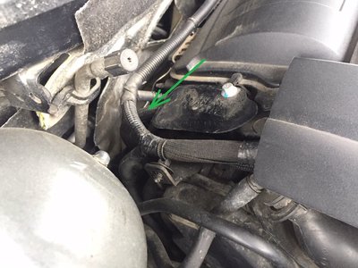

Re: Citroen C5 X7 Strange noise at the engine
I have found today the source of that buzzzzzz noise. It is a pipe going in something (I don’t know in what), if I block that pipe with the fingers, the sound it’s gone. Also, after every engine stop, I hear that buzzzzz very hard for 2 seconds. Is there a vacuum attic actuator or something? Shall I change it or try to repair?
I have made today two photos. Where I've added the green arrow, that's the hose.
Hi,
My car, the same engine as yours, had that problem. Also in my case if I block that pipe with the fingers, the sound it’s gone. The problem was with the solenoid. I replaced it and the sound stopped.
It's a rounded valve: 1618QQ ELECTRO VALVE
I bought a used car valve (2014.) and paid 25 €, and I replaced it alone.
P.S. you will need a little mirror and magnet for the 2 nuts you remove.
I hope you will succeed in solving the problem.
And yes, I have posted this post earlier.
Thank you for replying Leo. Would it be possible please to post also a link with the real part? Thank you! And an additional thing, are there two identical solenoids?
Leo, I have found a picture with the rear side of the engine. Which of the two identical solenoids have you changed? The left or the right one, according to this photo?
This is the part, about 20 Euro.
https://www.autokarma.ro/convertor-pres ... pa_order=8
Yes, that's the valve. In my case it was right from the picture .. it was rounded up in my post.
Ok, so that valve which is going to the turbo. Could this affect also the functionality or it is just a matter of noise?
I think I understood you wrong. The sound is still there even if you have replaced the valve? Or now you have not anymore the sound?
Now regarding the functionality, the right valve (from the engine photo) it's modifying the turbo variable geometry, which will ensure that you have a higher turbo speed even on low engine speed values.
The left valve I assume it's going to the EGR.
Dear Leo, thank you so much! I have replaced the valve today and the sound has gone! More than this, I have the feeling that the turbo is starting earlier, because the acceleration is better now.
Just one observation, the first hose was very easy to be mounted over the tube from the valve. I hope it will not fall down.
