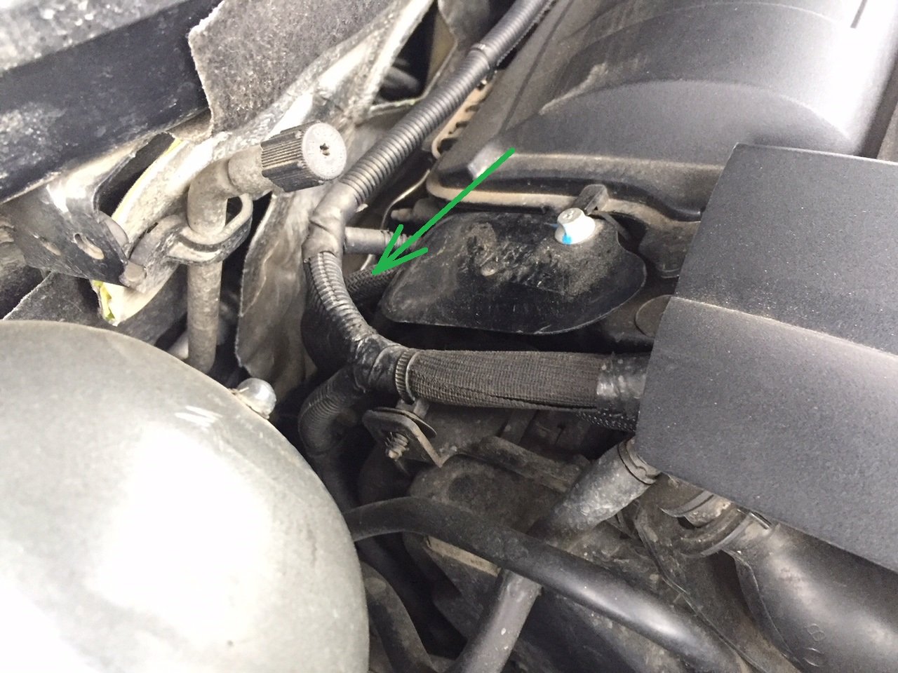

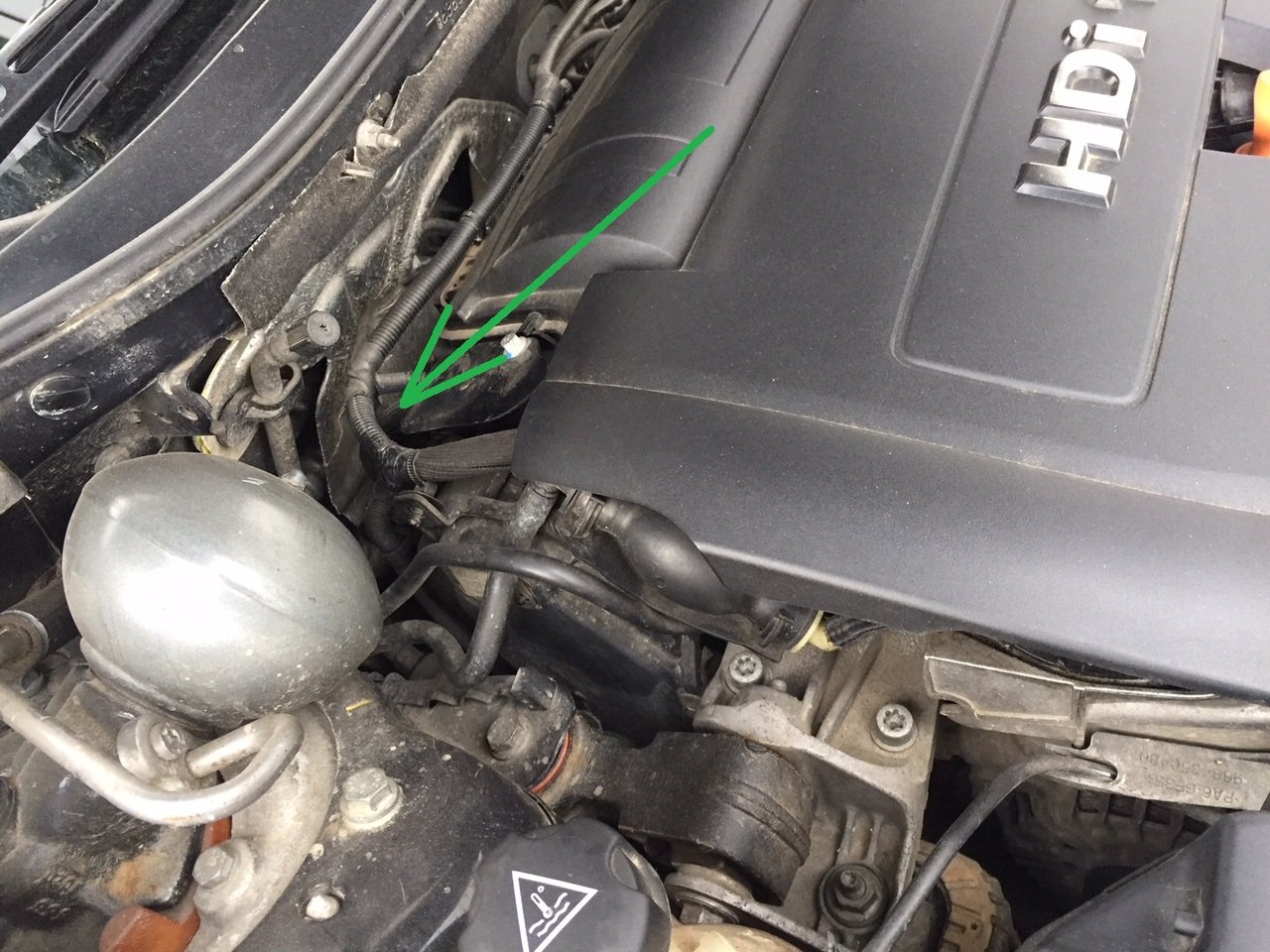

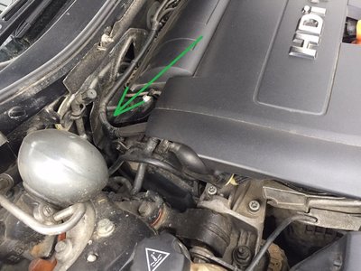

I have made today two photos. Where I've added the green arrow, that's the hose.

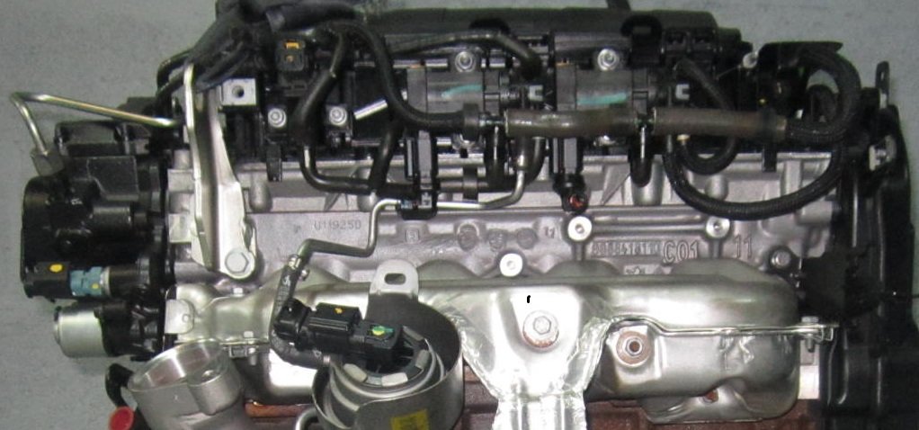

Leo, I have found a picture with the rear side of the engine. Which of the two identical solenoids have you changed? The left or the right one, according to this photo?

Re: Citroen C5 X7 Strange noise at the engine
Yes, that's the valve. In my case it was right from the picture .. it was rounded up in my post.

Now regarding the functionality, the right valve (from the engine photo) it's modifying the turbo variable geometry, which will ensure that you have a higher turbo speed even on low engine speed values.
The left valve I assume it's going to the EGR.
