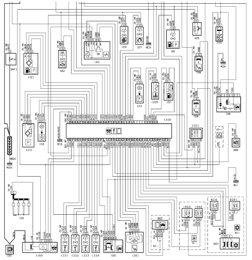

x 6945
Re: Erratic Speedometer
Ok, so here's the wiring for the Engine ECU, showing K2 connection (wire 6739) from the top of the ECU, located in the 48 pin brown plug.
Diagram in 2 parts again with overlap:
