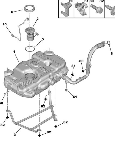

How did you come to this answer? Its just after more research and looking i saw on line what looked like an Eolys tank hidden away with the fuel tank and also the snapon type line that i have seen in various vids that has the green pinch tabs release, usually associated with the Eolys tank situated what looks like on my diesel tank?

The information is based on the VIS number you provided via Citroen's data. There are many engines fitted to this model and in your case it is the one without the Diesel Particulate Filter - which is why we usually ask for the VIN so we know exactly what you have and not what someone else may have that is a different but similar engine on the internet.
According to the VIS, you have a:
DISPATCH III SHORT PANEL VAN H1 TYPE 12 2.0 HDi 120 (DW10UTED4) with Manual gearbox 6 speed
However You will need to provide the complete VIN so I can double check and confirm the exact engine type.

Ok, confirmed - as I said before - no particle filter / additive system - diagram of your tank below:
