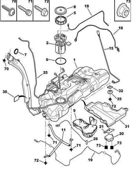

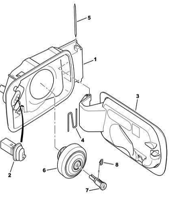

Ok, so I think we have some progress...
Here is the diagram for the fuel filler switch (Part No 2). So I'm assuming you need the wiring from that down to the tank...
So If I've got this right, you'll need part number 25 on the next diagram - which for your build number (RPO 10732) would be part number 6534 HY - which is 'Plug Presence Detect Harness'. This is currently priced at £103.99 inc. VAT from Citroen.
I hope this helps you with the part now.

The issue you are going to have is that they changed the harness from RPO 10948 - October 2006, to a new part (6534 NR) - so you'll need to watch out for this changeover if you are going to locate one second hand. I doubt this will be a shelf part for breakers unfortunately.

If you look back to the previous diagram, there is another harness (number 26) - which is called the 'Particle Filter Harness'. Although that does not seem to go anywhere near the fuel filler cap, that's the only other thing I can see - that wire is part number 6534 NV and is £27.84 inc VAT. But as I said I'm not sure if this is the one.....
(10) Permanent magnet.
(11) Contact.
The filler cap is fitted with a magnet and when the cap is closed, the magnet is opposite the contact.
Update:
