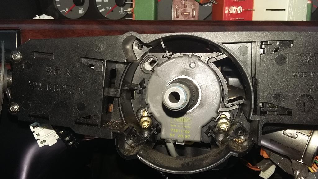

Xantia steering column disassembly, I wish to remove the steering column.
All plugs removed, all loose and all screws that I can see out, switchgear is all loose, but I do not want to force the grey bit

The grey bit is the steering angle sensor. It it a press fit on the column. Pull harder.

Owwwer !
