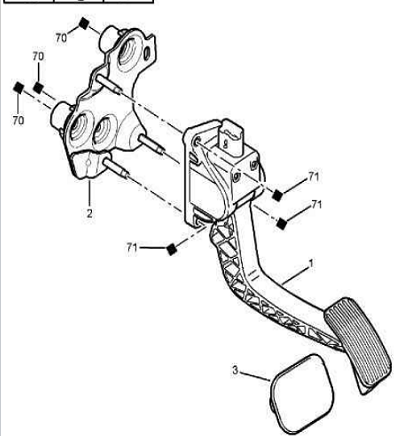

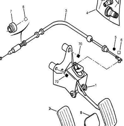

It depends on your model - some are fly by wire - with an electric potentiometer incorporated into the accelerator pedal or you may have the version with a cable. To check which you have, send a private message with your VIN.

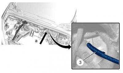

This picture below is related to doing the modification I mentioned - but it would indicate that the control cable is routed in / under / along the scuttle area: (a) being the location of the control cable.

Thank you Marc, as my throttle peddle is floppy would this be the cause for sure, I can lift it up and i when let go it just drops down, still drives ok just slow pulling out and in 2nd gear I’m flat out trying to get to 30mph lol
x 6961
Re: Picasso throttle cable
It’s a very good bet the cable has become too loose. The pedal should not be that low down.
If you can get someone else to operate the pedal it might help you locate it easier and find the adjustment thread. Do a little at a time until it returns to normal but don’t over adjust it.

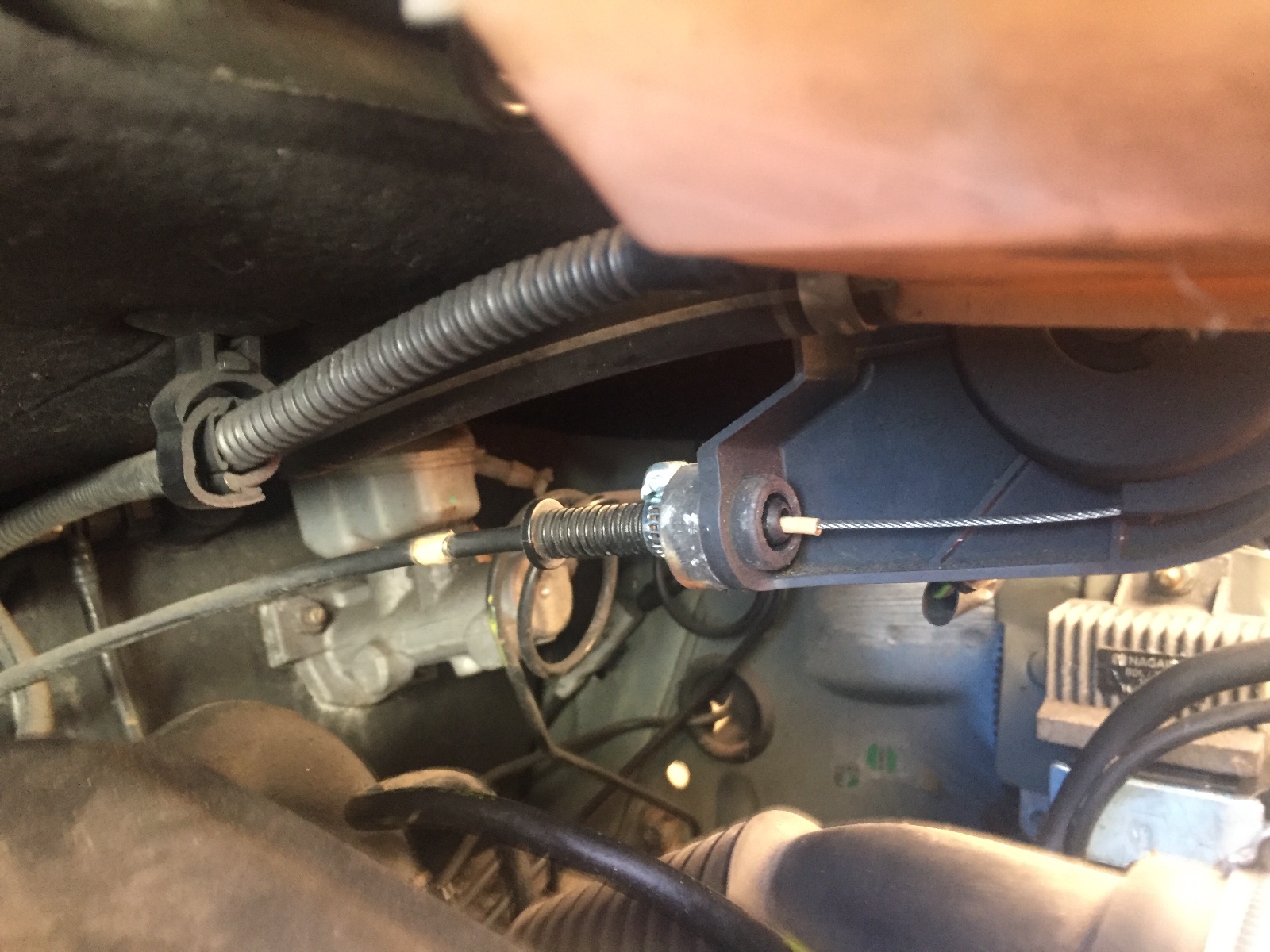

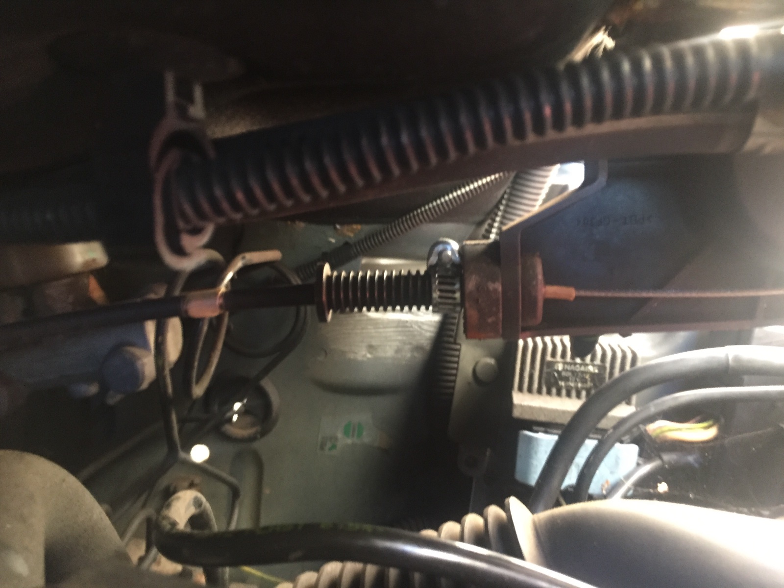

This is it, the black long thing just goes through the hole, is this bad ? Or do adjust another way

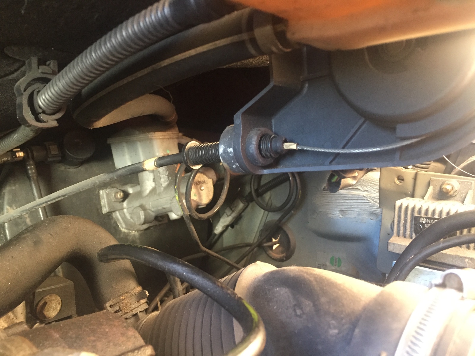

Would thick wire tie work
Ttwlr
Posts: 56
Joined: 17 Jul 2014, 13:16
Unread post by Ttwlr »
Done thIs and seems to work
What’s ment to be there?
