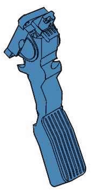

It's also possible that the Accelerator sensor could be playing up: Role of the sensor:
- To register the driver demand (acceleration, decelaration)
- To deliver the information to the injection ECU
- To determine the opening of the motorised butterfly
- To determine the injection time
- To determine the ignition advance

Re: C4 Picasso 1.8 (07) wont idle,EML lit/brake warnings and no brake servo
Yeah I saw that,one on Ebay just now. However the lack of servo on the brakes leans me towards the Throttle over pedal?
I'll be honest until I started reading up I didnt realise it was fly by wire.
