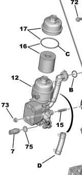

- Posts: 6847
- x 3565
Re: oil leak possibly id'd
To help locate the problem......

I've just checked the oil filter top and think I didn't have fully screwed on.
I'm going to buy a galleon of oil and new filter and change same.
So will clean area and hopefully that's it sorted.
