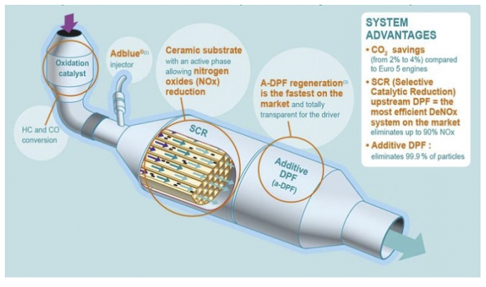

Re: Random C5 X7 question.
bigblackfalco wrote: 02 Jan 2018, 21:49 Did the C5 X7 Tourer ever get produced in a 3.0 V6 Blue Hdi variant or were they Eolys only?
Not to my knowledge - only the 150 and 180 2.0L variants.
The Blue HDi systems have both additive for the DPF and the Adblue for the SCR system. It's not one or the other they are a combined system: From PSA...
Thanks. I didn't realise that it was a 2 type emissions system on the Blues
