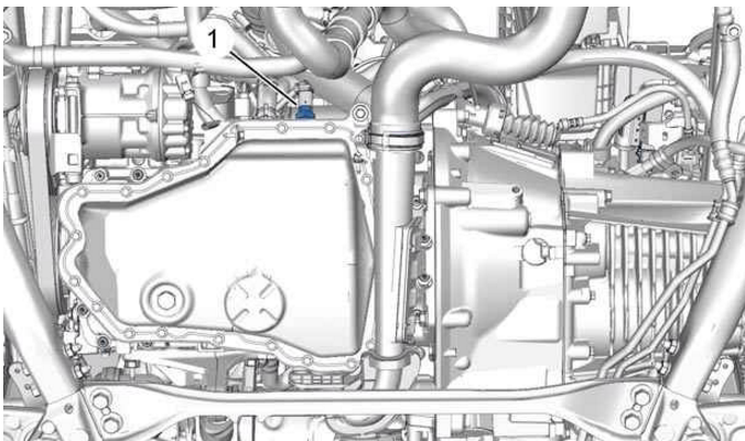

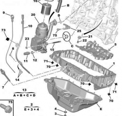

2] Oil Gauge fault (another member had this last week) - 1131 K6 £24.26 from Citroen Inc. See Pic below: Item number 7
Location:
3] You can ignore the last fault - this is caused by the diagnostic tool when running a diagnostic on the ESP ECU - known and confirmed to me as a ghost fault by Citroen - so long as it isn't accompanied by a dash warning concerning the suspension.

It’s a combined temperature and pressure sensor that one, It may just be the start of it being on its way out, and if it gets any worse then it might trigger the warning message on the dash.

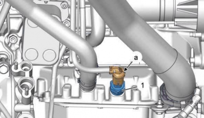

Details of the fault follow below, however I am aware that this problem can additionally be caused by 2 things:
1) Having a little more oil towards the maximum end can trigger it, or that the sheath of the probe itself can affect the measurement - and they have moved or replaced it in some cases. Normally it is s temporary fault and can also occur when the car is left on an incline. It should disappear, but if your physical oil measurement is a little ont he high side, sucking a little out may also cure the problem.
Failing that and if you are sure the part is correct, a software update may also rectify it.
Basically F159 is as you say the oil pressure sensor anomaly.
The oil level is measured correctly (Around 4750 ms).
The voltage measured is not within the range of authorised voltages (Lower than 40 mV or higher than 675 mV)
The light will kick in:
Now there are 2 types of oil pressure sensor - the correct one for your car should be Part 1131C5.

I seem to have got my descriptions mixed up a little, in my earlier post I replaced part 1131 k6 that I said was the "Oil Pressure Switch" which is actually the "Engine Oil Gauge"-
The part 1131C5 actually is the "Oil pressure switch, but surely if this was faulty then I would also get oil pressure warnings instead!
