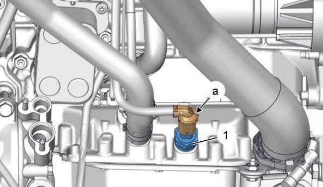

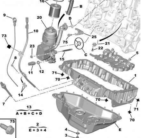

1] Have you changed any settings in the BSI or Audio ECU concerinng the type of screen fitted (there are several variations and the correct one needs to be selected)
2] Oil Gauge fault (another member had this last week) - 1131 K6 £24.26 from Citroen Inc. See Pic below: Item number 7
Location:
3] You can ignore the last fault - this is caused by the diagnostic tool when running a diagnostic on the ESP ECU - known and confirmed to me as a ghost fault by Citroen - so long as it isn't accompanied by a dash warning concerning the suspension.

It’s a combined temperature and pressure sensor that one, It may just be the start of it being on its way out, and if it gets any worse then it might trigger the warning message on the dash.
