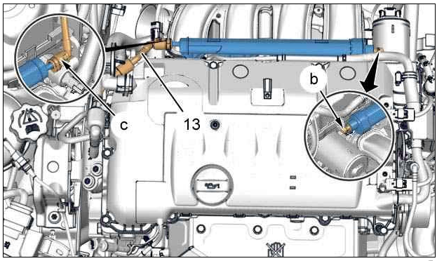

Hi,
My DS3 seems to have developed a fault that I'm hoping some of you guys might be able to help with.
When I accelerate, at low RPM the engine hesitates/holds backfor a second or 2. It seems to be most notable when going up slight hills, it hesitates then continues as normal. The rpm doesn't drop or jump when it does it.
Ive spent hours googling stuff and thought it could be a fuel filter issue, I've bought one but now can't find the bloomin thing on the car, I can't find anything whatsoever about in the internet either :roll:
If you guys can't help then I'm going to have to bite the bullet and go to a garage, I really can't afford it at the moment otherwise I'd take it straight to one.
Thanks for reading
Aaron

Is this the turbo engine? Post up the last 8 digits of the VIN, and we can have a look, but quite common for modern cars not to have a fuel filter.

Re: DS3 engine hesitation and the mystery fuel filter
There is no part listed for the replacement that I can see, but this might be it shown at (13) and closer at (C) in blue.
To get to it the Air filter housing has to be removed - BUT, as with anything on high pressure injection systems, I would be extremely cautious about doing any work on the fuel circuit.

GiveMeABreak wrote: 26 Oct 2017, 12:07 There is no part listed for the replacement that I can see, but this might be it shown at (13) and closer at (C) in blue.
Thanks for the graphic, I've decided to book the car into a Citroen specialist, I'll update this thread when it's sorted in case anybody else has a similar issue. I'll also ask them to confirm if that is indeed the location of the fuel filter!
