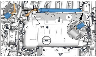

There is no part listed for the replacement that I can see, but this might be it shown at (13) and closer at (C) in blue.
To get to it the Air filter housing has to be removed - BUT, as with anything on high pressure injection systems, I would be extremely cautious about doing any work on the fuel circuit.

GiveMeABreak wrote: 26 Oct 2017, 12:07 There is no part listed for the replacement that I can see, but this might be it shown at (13) and closer at (C) in blue.
Thanks for the graphic, I've decided to book the car into a Citroen specialist, I'll update this thread when it's sorted in case anybody else has a similar issue. I'll also ask them to confirm if that is indeed the location of the fuel filter!
