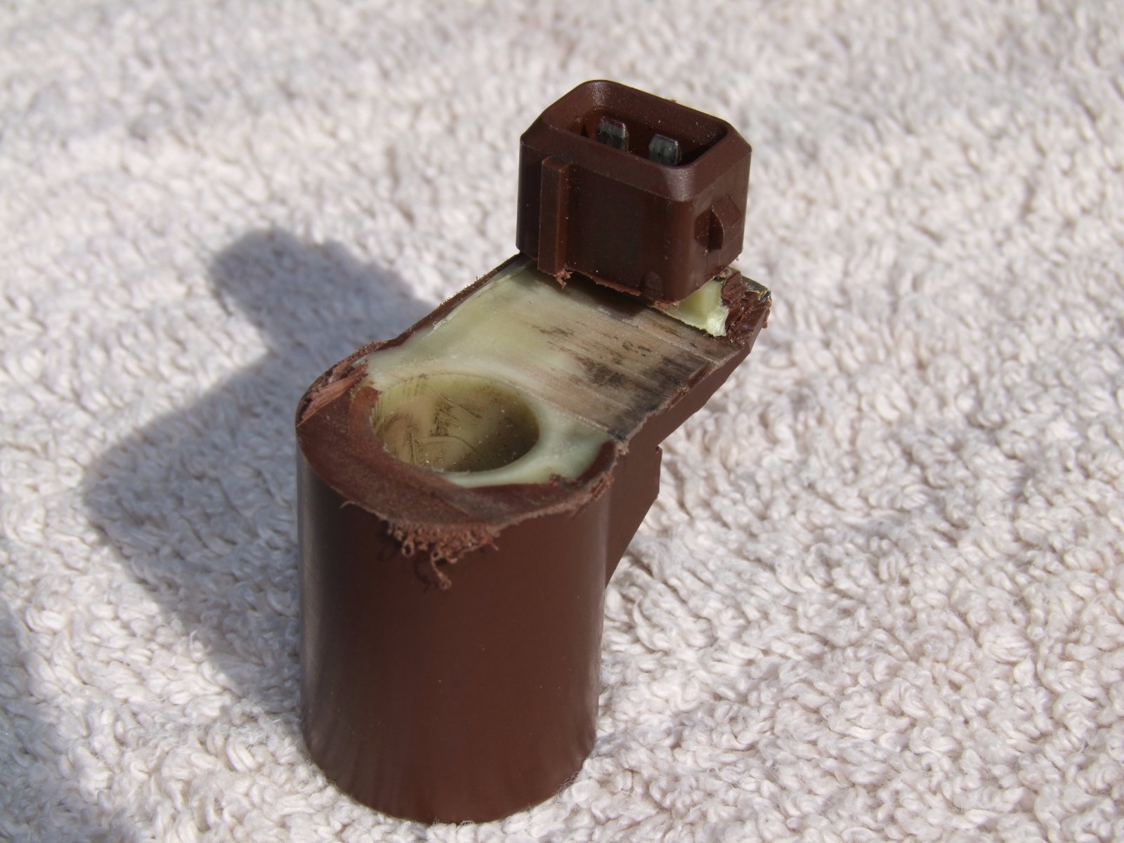

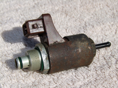

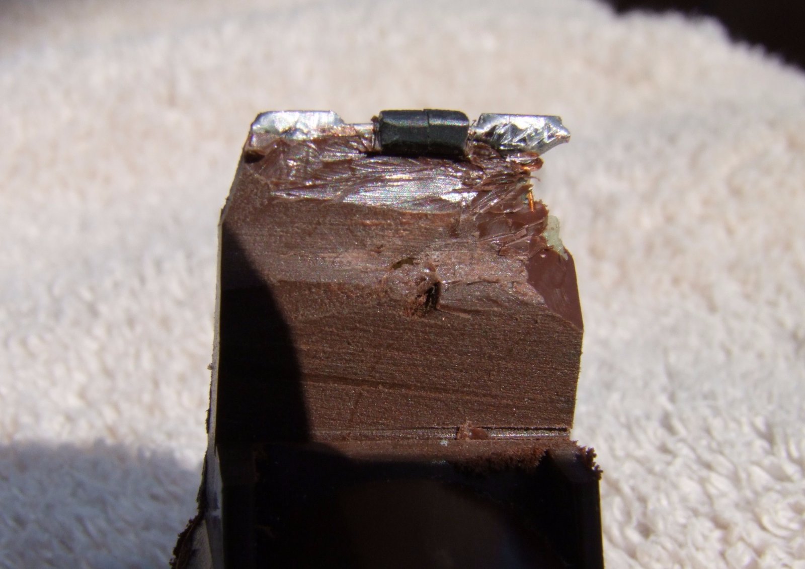

Good bit of discussion recently about failure of suspension electrovalves (Xantia, XM...), and the small diode built into the EV solenoid body.
Finally got round to taking a failed one, and opening it up.
After unscrewing the two halves of the central hydraulic valve, the steel cover and solenoid brown sleeve were pulled off, and the brown casing sliced around the front face with the bandsaw...

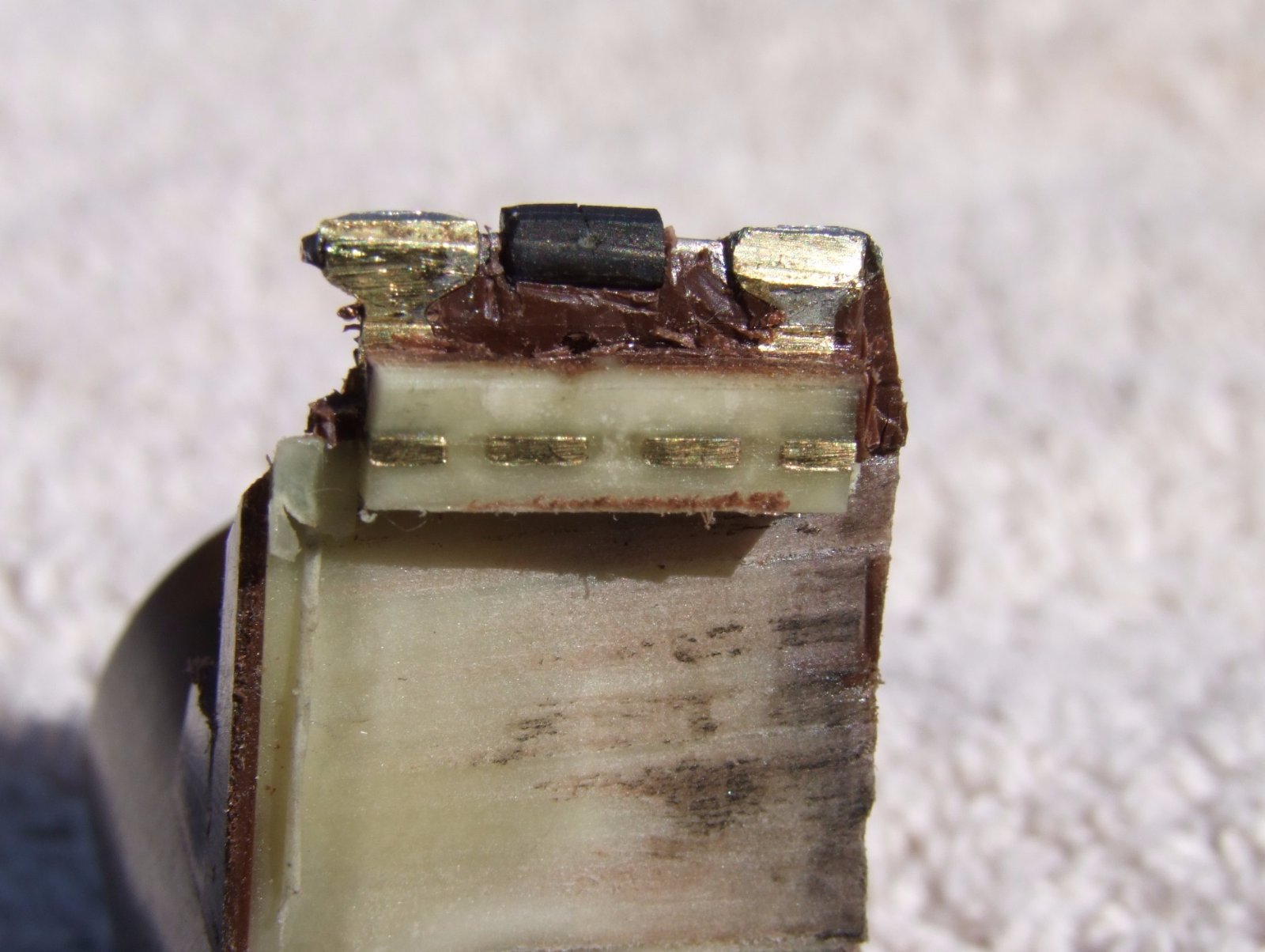

Next to come off was the two-pin connector, which surprisingly revealed four terminals below. Clear that the outer brown plastic case was filled with white epoxy resin (potting compound), encapsulating all the innards - coil, diode, and internal connections.
The centre two brass pins were the externally visible + and - connections.
After a bit of shaving away of brown plastic, clear that the hidden outer pair carried the diode and coil connections.
The diode and coil wire ends were generously soldered to the brass outer terminals. There were some markings on the diode (about 1N4xxx size), but nothing which could readily identify it.
______________
The whole EV assembly is definitely something not meant to be taken apart. The two halves of the central hydraulic shuttle valve are thread-locked together, and require considerable force to break the seal. This gives access to the internal valve parts.
The resin-filled solenoid assembly (coil, diode, terminals) is not for opening up for repair!
Simon has written some useful guidelines for testing these units, without destroying the internal diode (raw 12v must not be connected to them). Additional external diodes will offer protection for the ECU, and enable proper solenoid action where the coil is still working.
______________

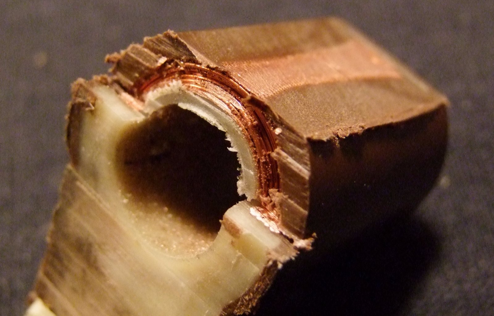

Out of curiosity, I wondered how fine the solenoid windings were. Some relays can have pretty hair-like wire.
Cut and sanded down part of the brown casing...
Found the winding to be full length and 3mm thick. Enamelled copper 0.4mm gauge, so surprisingly stout.
Given this, failure of the winding I would think unlikely, unless subjected to burn-out from a continuous 12v.

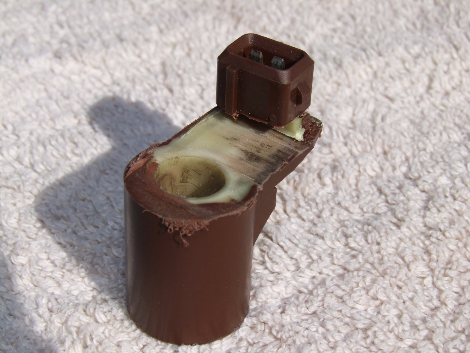

Some interesting picture here! I must track down the notes referred to for non destructive testing.

Chris, most interesting
Thanks for doing that for our ongoing education

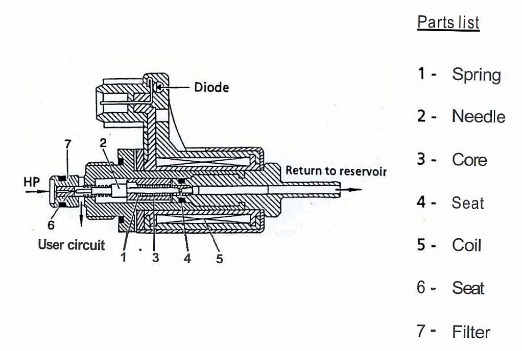

I did not expect the diode to be that large, physically...
Interestingly, I have never known a 1N4000 series diode replacement to fail so I guess the OE encapsulated diode must be either poor quality or marginally speccd, especially in terms of PIV (Peak Inverse Voltage).
Another oddity is that in most cases diodes in rectifier service fail short-circuit. It is relatively unusual for them to fail open.
This is indeed so... The nearer the better in theory but in practice, the usual location of the repair diodes works perfectly adequately.

I've only handled two EVs with failed diodes: both of them had gone short-circuit.
Agree that the best location for external protection diodes is close to the coil, but not a lot of fun installing there. Maybe an additional male-female 'brown' 2pin "through connector" containing a diode might do it, if there were room, and if connection was reliable. PSA-type push-on connectors don't have a great track record though.
Good few folk have fitted additional diodes at the ECU connector, but - I'm guessing here - as a preventative measure, in case of OE EV diode failure and possible damage to ECU output. Do wonder how many cases there were where the diodes were fitted there to cope with a failed OE EV diode . . . and did it cure it?
I've got a couple fitted at the ECU - 400V 6A, and taken to a good Gnd. At least the wiring from ECU to EVs is a decent gauge, otherwise fitting there might not be such a good idea.

That's pretty clear confirmation that fitting 'additional' diodes reinstated normal working.
Didn't think for one moment that there would be bare wires there!!!

I only dissected the solenoid out of sheer curiosity, Peter. Had a duff one (shorted) on the bench, so wondered about both the diode (what sort?) and the coil windings (how sturdy?).
You're right - absolutely no real possibility of repair . . . unless you went in for a bit of "blind drilling" to tap into those outer hidden contacts!
Good to find sturdy windings, though. Wonder if there's a reliable way to "blow" a shorted diode open (without harming the coil) so that an external diode could do its job? Sounds like one for you or Jim....

Chris, given the sturdiness of the windings, I'd be very tempted to try, if you find another coil with a short-circuit diode, 'blowing' it open-circuit by applying a pulse of very high voltage to it...
I'd have to think of a good source but my first choice would be an old-fashioned 'Megger' insulation tester as used by electricians...
I did think of using the car ignition system but that would be a bit too much!
