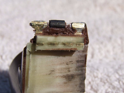

Next to come off was the two-pin connector, which surprisingly revealed four terminals below. Clear that the outer brown plastic case was filled with white epoxy resin (potting compound), encapsulating all the innards - coil, diode, and internal connections.
The centre two brass pins were the externally visible + and - connections.
After a bit of shaving away of brown plastic, clear that the hidden outer pair carried the diode and coil connections.
The diode and coil wire ends were generously soldered to the brass outer terminals. There were some markings on the diode (about 1N4xxx size), but nothing which could readily identify it.

The whole EV assembly is definitely something not meant to be taken apart. The two halves of the central hydraulic shuttle valve are thread-locked together, and require considerable force to break the seal. This gives access to the internal valve parts.
The resin-filled solenoid assembly (coil, diode, terminals) is not for opening up for repair!

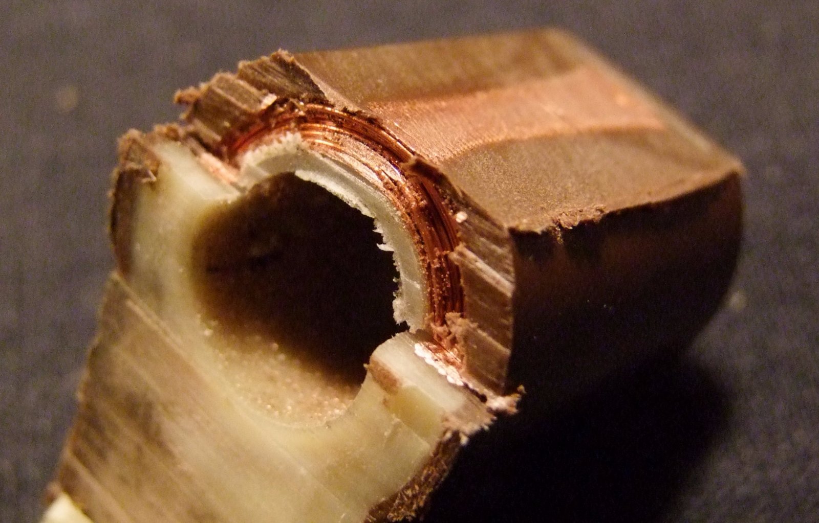

Out of curiosity, I wondered how fine the solenoid windings were. Some relays can have pretty hair-like wire.
Cut and sanded down part of the brown casing...
Found the winding to be full length and 3mm thick. Enamelled copper 0.4mm gauge, so surprisingly stout.
Given this, failure of the winding I would think unlikely, unless subjected to burn-out from a continuous 12v.
