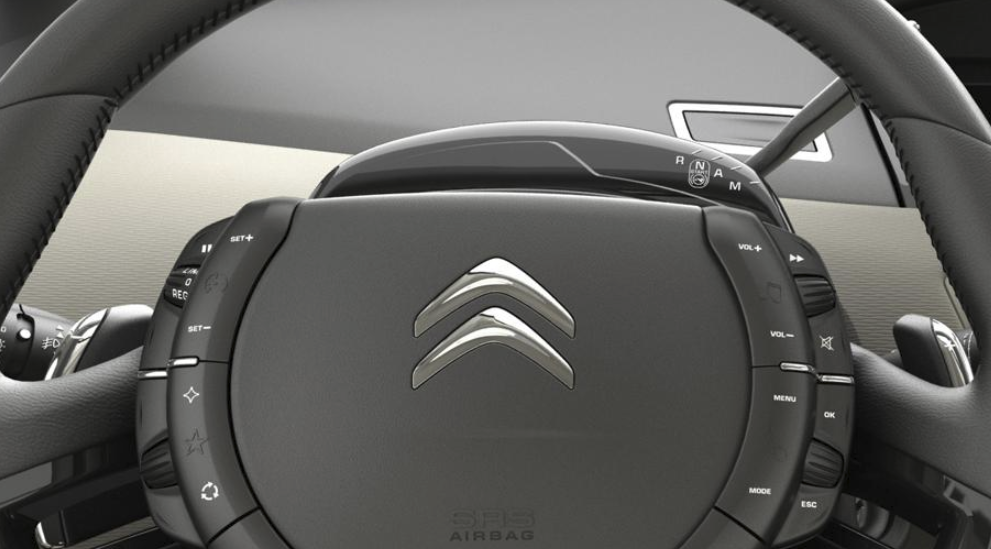

I have read that you can drive the EGS as an auto?
- x 6946
Re: Citroen C4 Picasso 1.6 HDi Exclusive EGS 5dr 2007 TO BUY OR NOT TO BUY
You can choose to change gear by manually moving the gear changer up or down (flappy paddles in this case), or put it into automatic drive and the car will do it for you. BUT it does not have an automatic gearbox as I said - it just changes gears by computer control using a normal clutch and normal manual gearbox.
In this picture, you have the lever at the top which you can put into M for manual, A for auto N for Neutral. If in manual, you then use the 'flappy' paddles on the left or right of the steering wheel to change gear up or down as you want.
