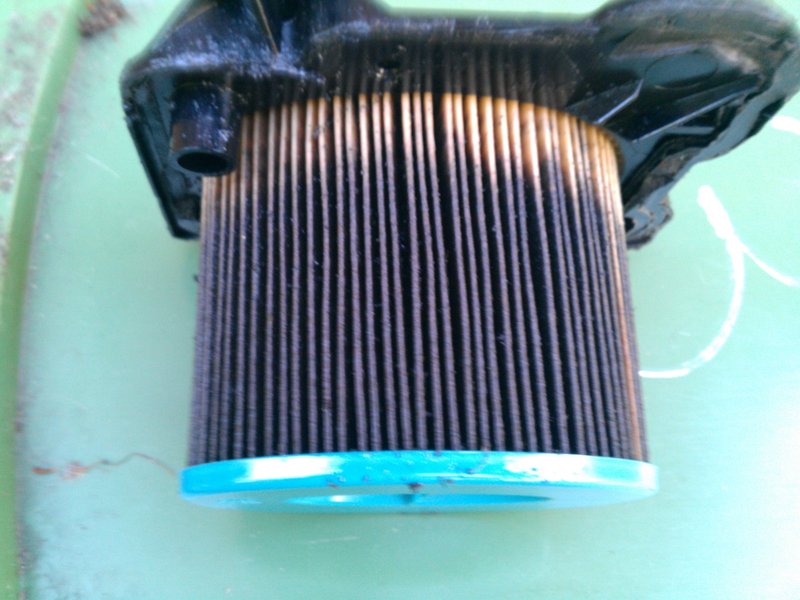

Gosh Mike, that air filter...
Can't see why you changed it really. It was good for at least another mile...

Soot - looks like the wrong clip on the EGR valve inlet - it should be an all round clic-loc affair, rather than that screwed up job, suspect that is where the leak is coming from.
MAF - normal - both of mine are like that

Jim, the pollen filter isn't so bad, looks like the leaking air intake served a purpose and hoovered up most of the soot into the air filter.
Thanks Richard. So that's the EGR valve, that long cylinder? I'll take a looksee on service.citroen if it's got the wrong clip. Bad mechanic... (just looked, not egr, but service.citroen doesn't show the clip either. Odd.
Glad to know the MAF's not been messed with!
