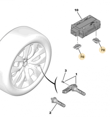

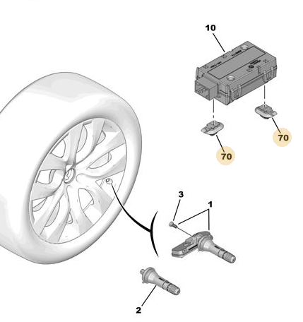

Yes, I have lost the plot again - you are correct Leo, apologies, I was getting this mixed up with another query on another site!
AS the OP has the 138 DWBTED4 engine and 225 / 55 / R17 wheels, he will need:
Part 1610529180 for the Receiver (10)
Part 9811536380 for the Wheel Transmitter modules (1) for his RPO.
Part 1610695980 for the 2 clips for the receiver module. (70)

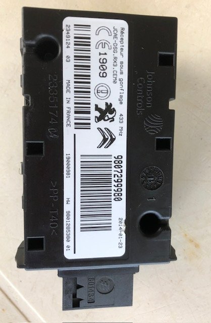

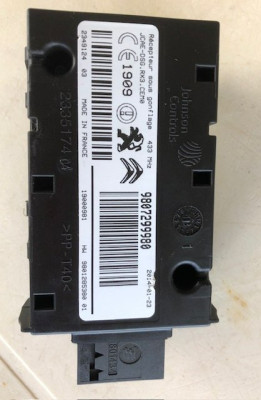

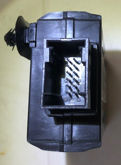

Citroen C5 x7 2014 tyre pressure module
I am trying to locate the receiver module for the Citroen C5X7 2014 Vin VF7**************[VIN obfuscated, can be read by forum staff] SEDAN. I have attached a picture of the module. Its a 12 pin connector. I have seen a version of this one (Made in France) on
Aliexpress.
>>> https://www.aliexpress.com/item/1005009 ... 211%210%21 Checking to see if any one else has bought this one and if it worked ok.
Aliexpress.
