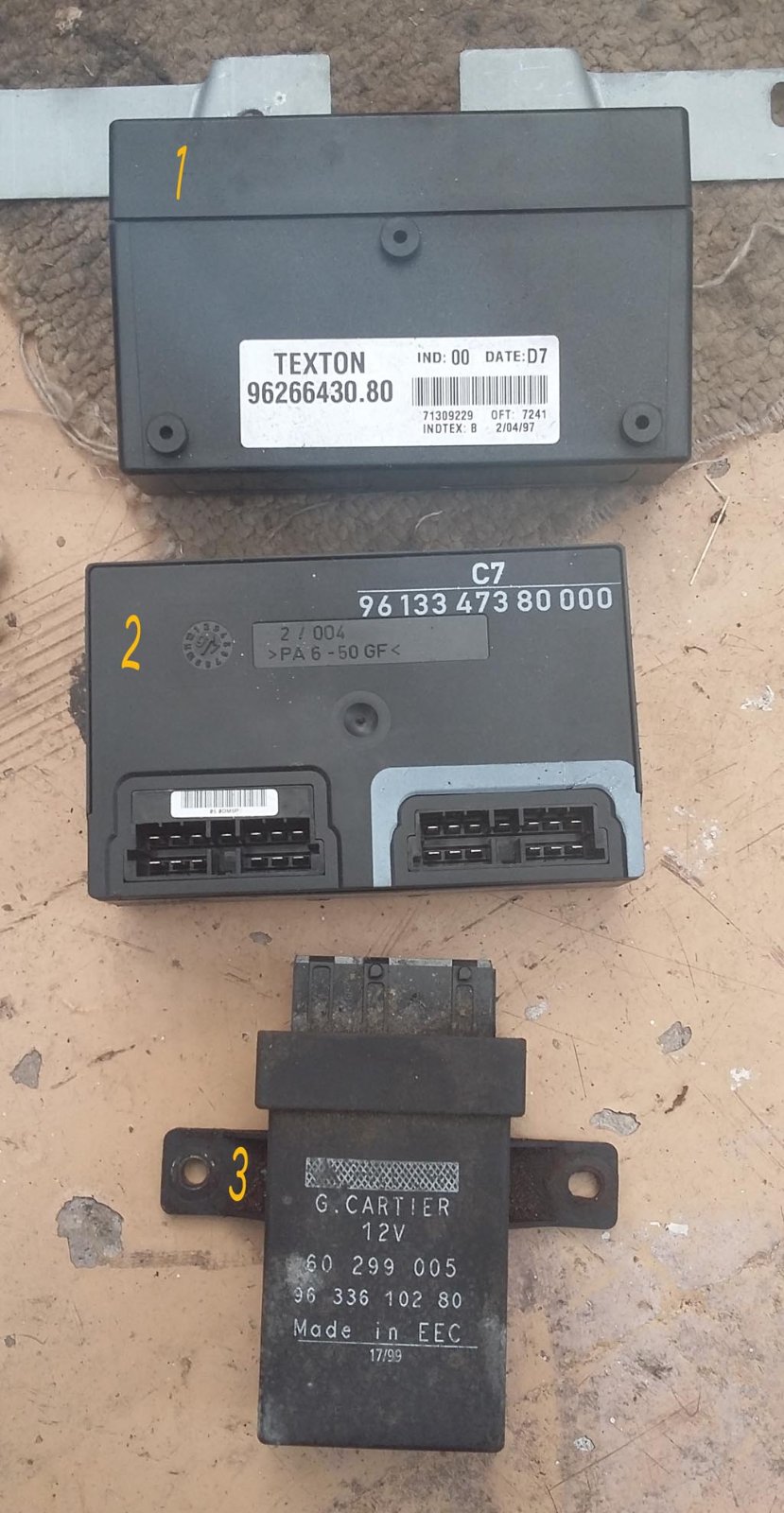

Xantia ECU's identify please
1,2,3.....what are they for ?. are they car (model/age) specific ?

Re: Xantia ECU's identify please
Middle one is the Alarm/Central Locking ECU, bottom one is the Cooling Fan Controller ECU...
All for an S1.. Top one I'm not 100% sure of. Was it mounted in the driver's door? If not, where was it?
Number one looks like a CPH module from a mk 2.
Again where was it located & what do the connections look like?
The top one looks similar to the c/l ECU from my old XM. That was under the glovebox.
Not a clue where No1 was....but it must me an interior fitting being clean/no rust.
thanks for the info on 2 + 3.....I can keep these then.
Googling texton 96266430.80
Will give you the impression that it's the alarm recieving unit (number 1)
It's familiar, I think I found one under the passenger seat.
If you have the plips that go with 2 keep them all together. They are repairable but it's far easier to swap the ECU and use the pre paired plips. Ecu2 is where the plip code is stored.

I do have the keys.......
but what is No1
but what is No1
There's s thread in clubxm that suggests it's the alarm receiver.
Unfortunately I can only read the Google blurb, clubxm won't let me in.
It let me in!
It is the alarm receiver.
http://www.club-xm.co.uk/forum/viewtopi ... +80#p94157
http://www.club-xm.co.uk/forum/viewtopi ... +80#p99914
