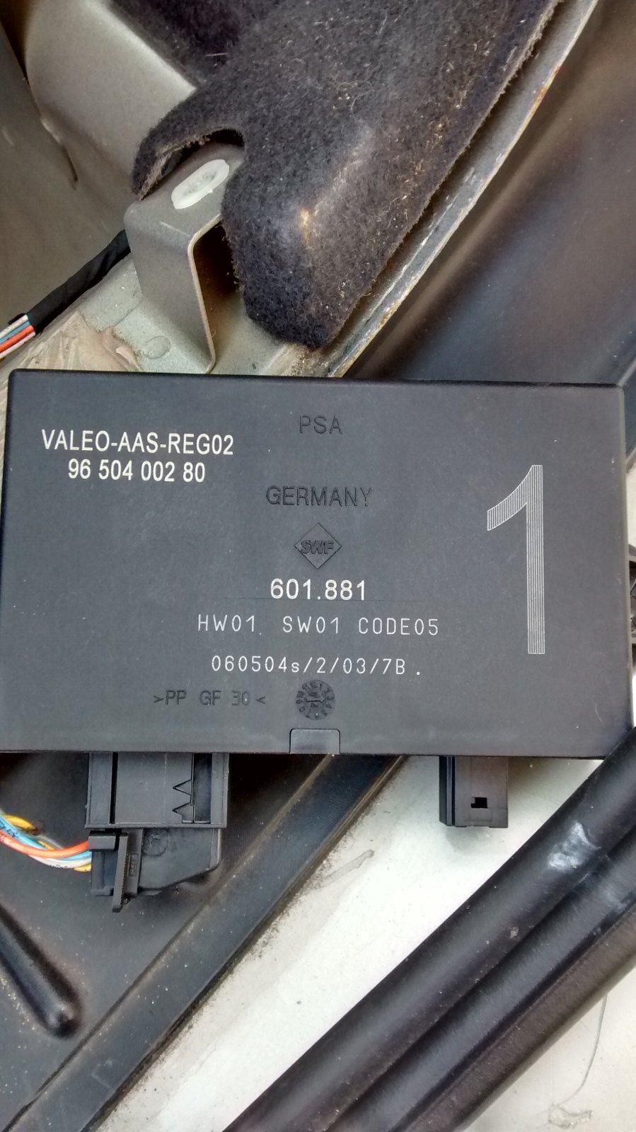

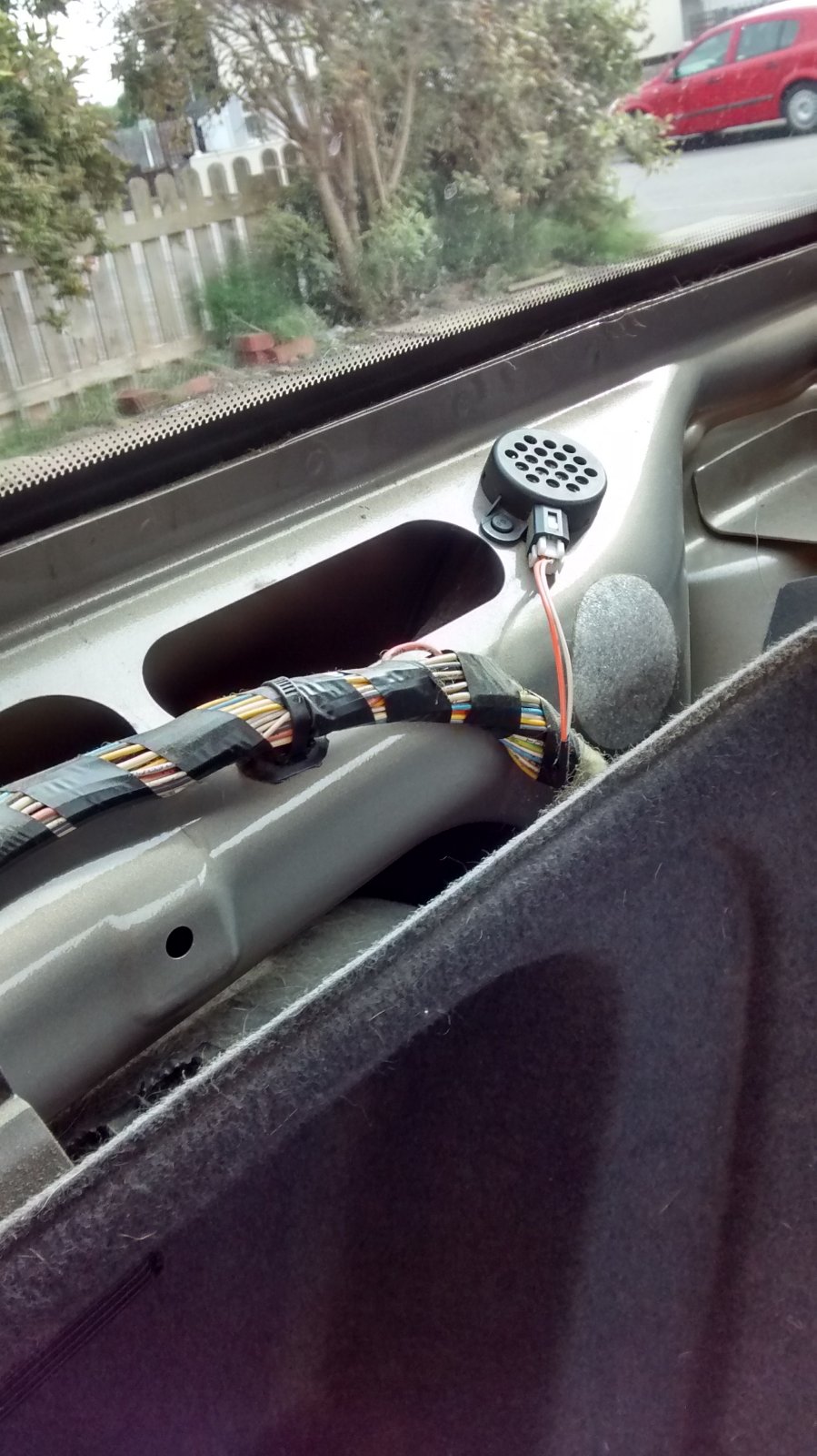

Err where is it? :evil: according to bol it's behind the r/h luggage panel but there's nothing there. If I start in park and move to reverse or d I get a beep beep every second or two. If I start in neutral and move to d then no beeps. The reverse sensors have always played up so think it might be associated. No warning messages, lights, nothing just bloody beeping. I though if I could unplug and try it, it might just prove if that's the prob. Got half the car stripped out now!

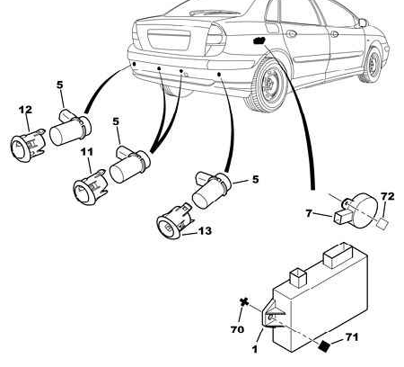

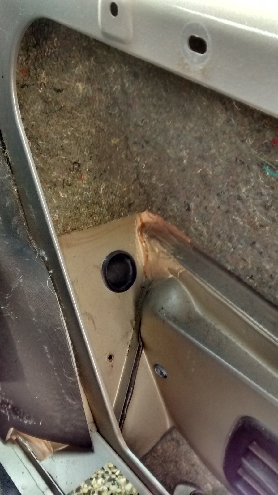

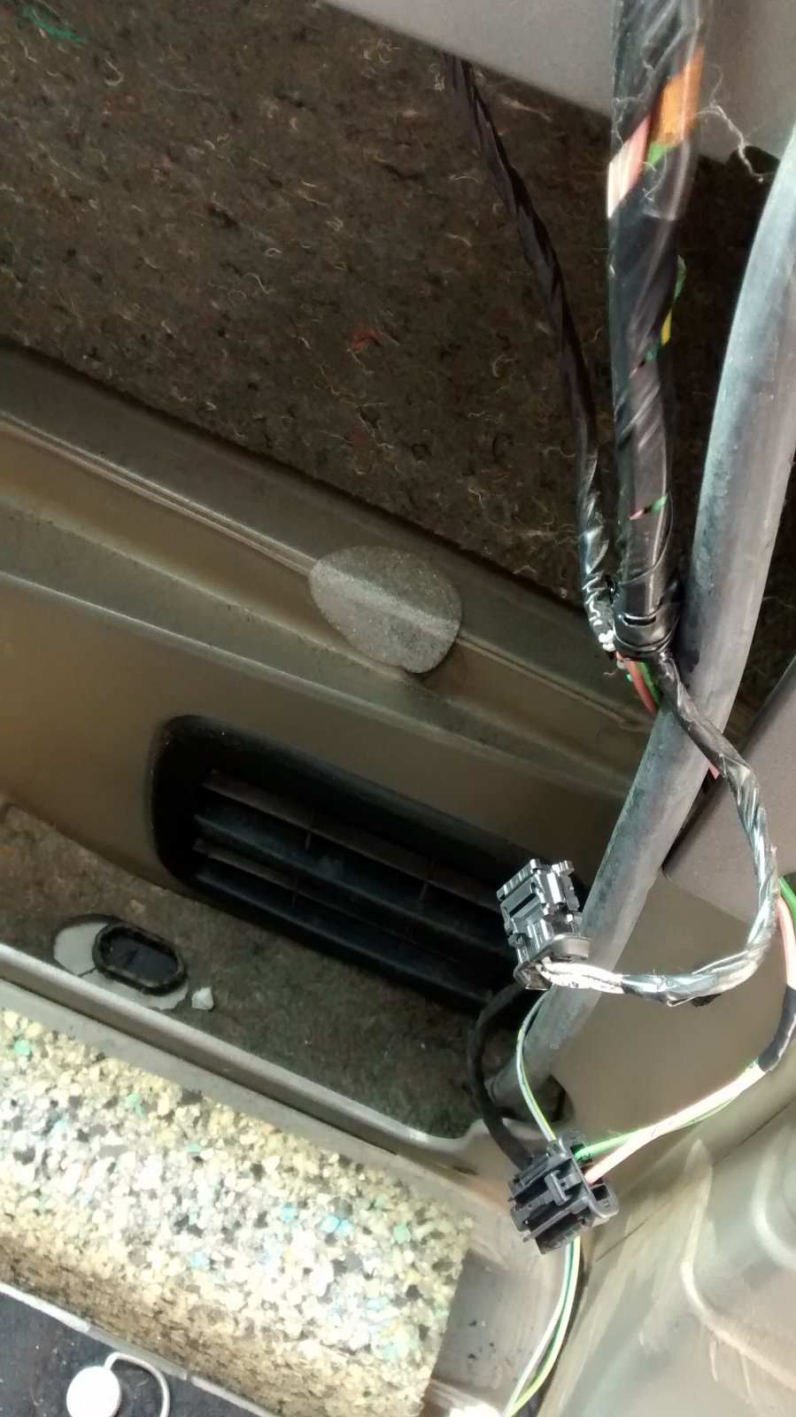

It's in the boot, rear driver's side, usually to the right of the spare wheel, mounted on the body - on the Mark I it may be behind the trim fabric though:

Found it by the spare wheel thanks Marc. Disconnected the sensors but still got the bleeping beep! So now I'm wondering does there need to be a resistance to register. I'm going to dig the laptop out.

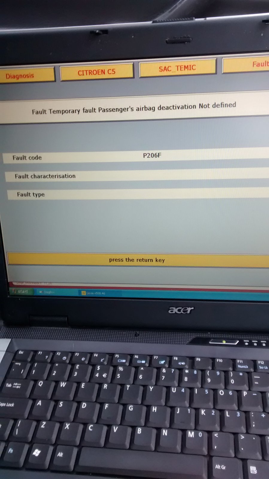

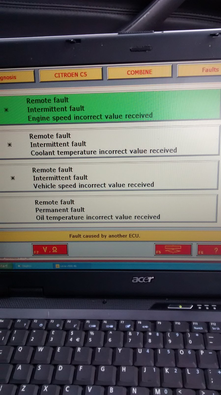

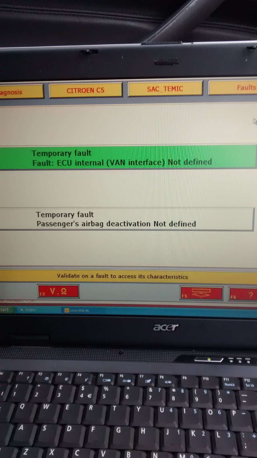

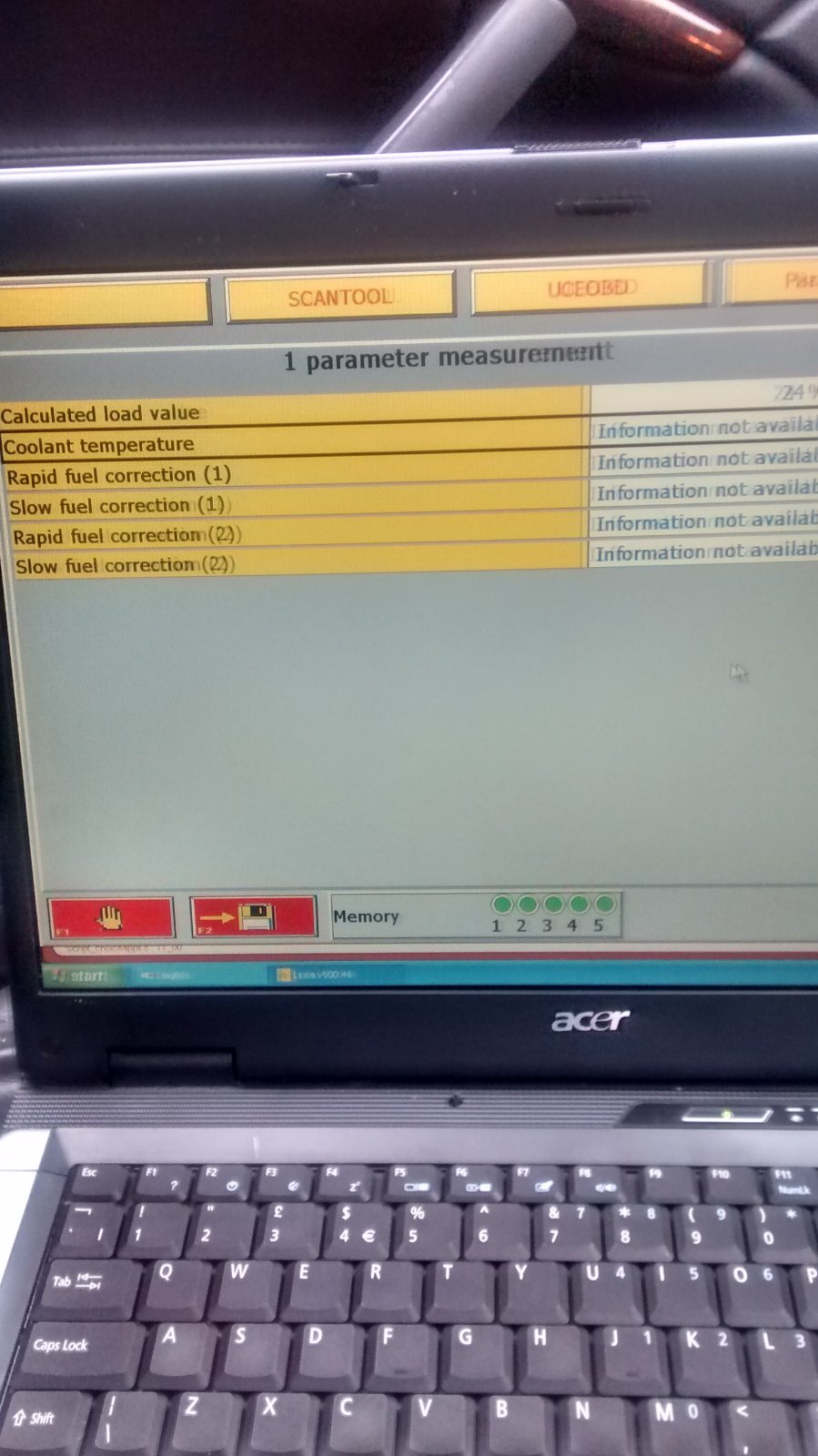

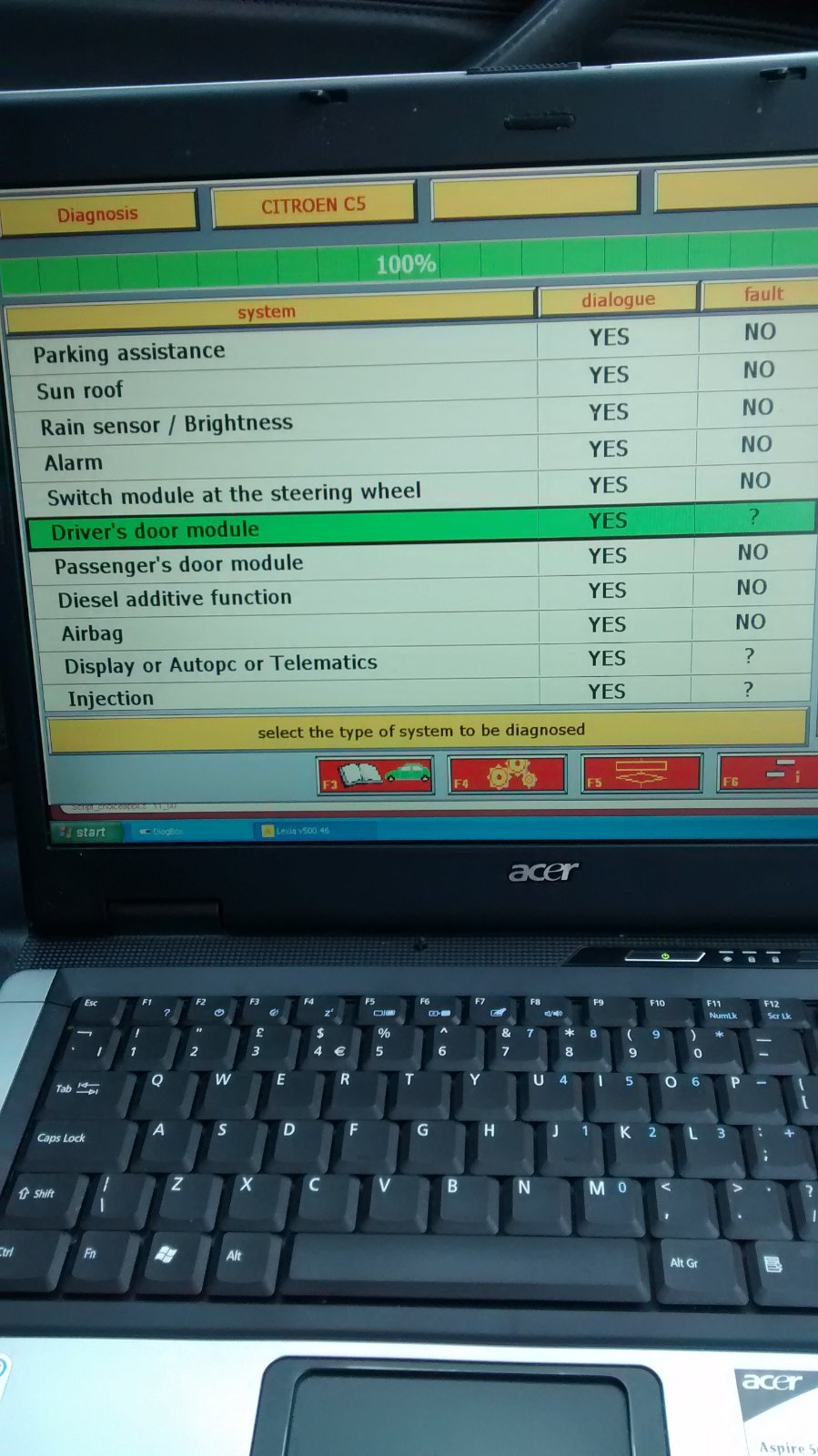

I did a Lexia session and the parking sensors read ok with no faults. There were a few other faults though but I erased most of them. Not being an expert I wanted to look at the engine parameters which I presume is done with Scantool. I got connected but it couldn't read anything but I'm not sure if that was down to me. Please see pics later.

Parameters are within the Lexia program, Dave.
My method (there may be a more efficient method I'm not aware of) is to choose the relevant ECU, scan for codes then clear them. Once that's done, the parameters sub-menu becomes available.

I'm not much further Dave, still a complete novice. I didn't know the scantool is supposed to work, it hasn't for me.

Sussed it, I now have a silent car.
So here's a little tip for everyone, if you have a dashcam make sure you remember to replace the memory card when you remove it! :rofl2:
