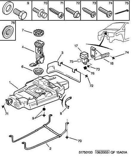

The VIN is missing a 7, but I've corrected that and it shows as a:
EVASION FAMILY SALOON 2.0 i Manual gearbox 5
INJECTION XU10J2 (XU/XUD)
MAGNETI MARELLI Injection system
Fuel Tank Diagram: Fuel Pump is 4

Yes that's correct. Thank-you very much. Is the pump accessible via the floor or is it a tank out job?

Its been years since ive been near a Synergie but im pretty sure its a tank drop down job to change the pump. Just like Xsara Picassos though you don't need to fully remove the tank just drop it at one side.
Must say ive never heard a fuel pump go with a bang
I would check if there is a power supply & earth at the pump when its turning over before buying a pump. Sometimes thumping the underside of the tank while someone is trying to start the engine can (temporarily) make the fuel pump start working again.

Thanks for looking anyway Marc. I didn't want to spend time taking the seats and floor out only to find I can't get to the unit anyway.
Wheeler- thanks for that. I was hoping to be able to test the pump without crawling around under the car but it looks like that's what's going to have to happen.

You can access the fuel pump/sender unit by just lowering the offside of the tank, it will lower just enough to get it out, no need to undo the fuel filler pipe.
