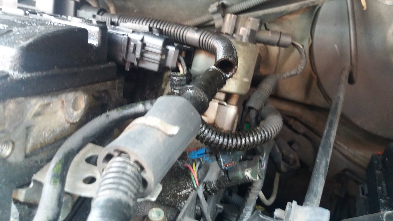

Broken pipe
Anyone know what this pipe is that has snapped off and roughly how much a replacement is my car is an 2003 Citroen xsara picasso 1.8 petrol

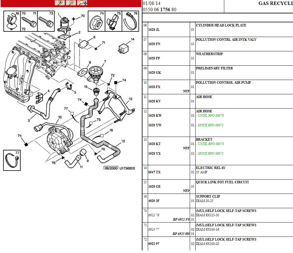

Looks like a crank breaker pipe to me....I would just put a joiner pipe into it

I got away with a repair on my Xantia with the same issue. At 21 years old and with the V6 heat I reckon if I got away with it you have a decent chance. I filled the external grooves with silicon and sheathed it with suitably sized fuel hose.

Before i repair the pipe would i have to give it a good clean cause it was covered in oil

Yes if you use an adhesive or sealer like I did.
I sprayed mine a few times with contact cleaner.
Probably not the ideal solvent but I didn't want to brush or touch the pipe for fear of it disintegrating.

If the pipe is that delicate, the affected section should be replaced,
The only way to find out is to handle/flex it.
You may be able to splice in just a new section of that lengthy pipe.

white exec wrote: 27 Aug 2017, 16:46 Some black electrical flexi-conduit could turn out to be tougher, so long as it's not the stuff PSA use!
That's what I used, attached / reinforced with heatshrink.
