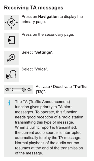

Ok. so you have the SMEG Touchscreen system, but without Navigation. Assuming you have set the system up as per the manual below, I can only suggest it is the radio signal as Jim suggested.
