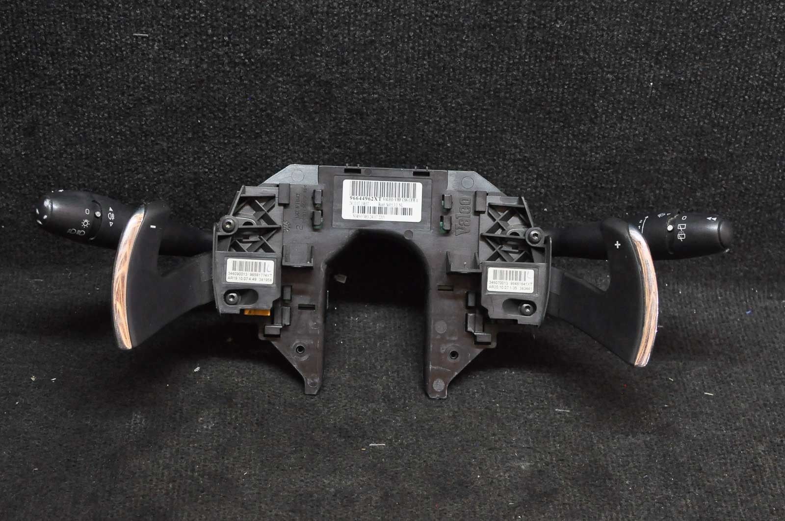

I've always been a bit jealous of the EGS6 equipped C5's that have flappy paddles.
Is it possible to replace the standard "switching block remote control" as Citroen so eloquently put it with the one from a C5 with flappy paddles?

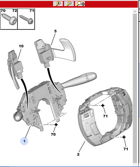

These are the items in question.. It looks as if the paddles themselves are separate to the base unit so maybe the entire unit doesn't need replacing?
Of course this all depends on how the signal to shift gear is sent to the gearbox. From my investigations with Diagbox it seems like all the normal gear stick does (when in manual mode) is send a CAN command so presumably these paddles also send the same command?
http://www.ebay.co.uk/itm/CITROEN-C4-PI ... SwHnFVjTV5
I'm tempted to buy a pair here and see if they work out of the box..... what could possibly go wrong

I would suggest a big not on that one Ellis. These controls are designed for the manual gearbox control system - and different to the fully auto system you have. The software will no doubt be designed to work with the specific ECUs for the EGS gearbox and clutch actuator systems and not the AM6.
You've already got it easy with an auto, lucky so and so - what about a nose scratcher while you're at it?
EDIT:
Just confirmed that the Steering Wheel gearbox switches do go directly to the Piloted Manual Gearbox ECU on the STOP START models.
EDIT:

Thanks for checking that one regarding the wiring, If the paddle switches were wired back to the BSI then it might be possible, but if it's back to the gearbox ecu then obviously not.

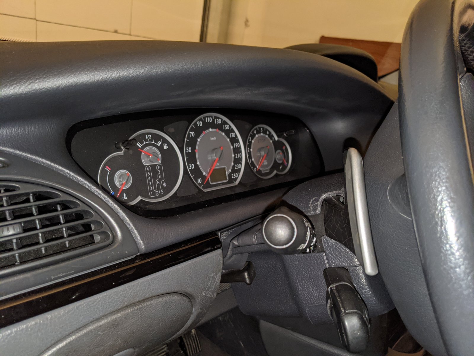

Re: Retrofitting Flappy Paddles to a C5

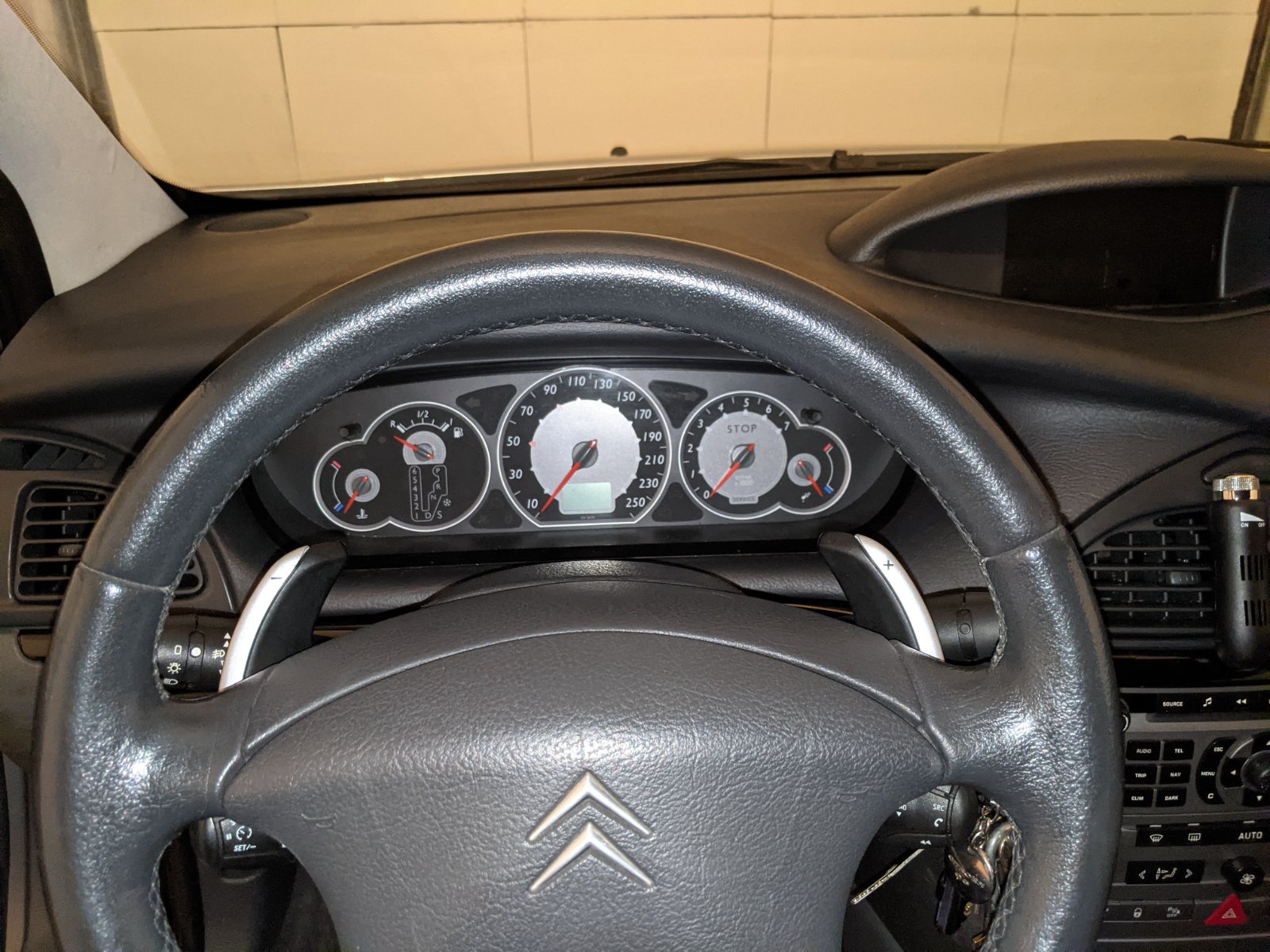

Here's V6 diesel with flappy padels retrofitted:
- Posts: 3
- Joined: 31 Jan 2021, 22:05
- Location: Teramo Italy
- Lexia Available: Yes
- My Cars: C5 2007, 2.0 HDi 136cv, Exclusive automatic, 127.000km
ex. C5 2003, 2.2 HDi 133cv, Elegance manual, 213.000km - x 2

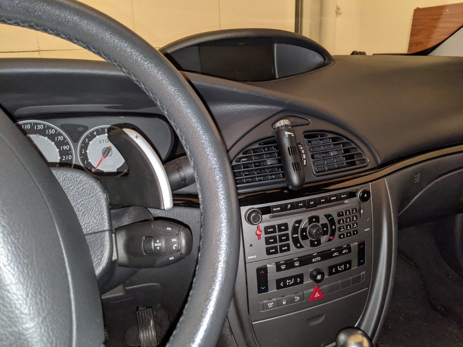

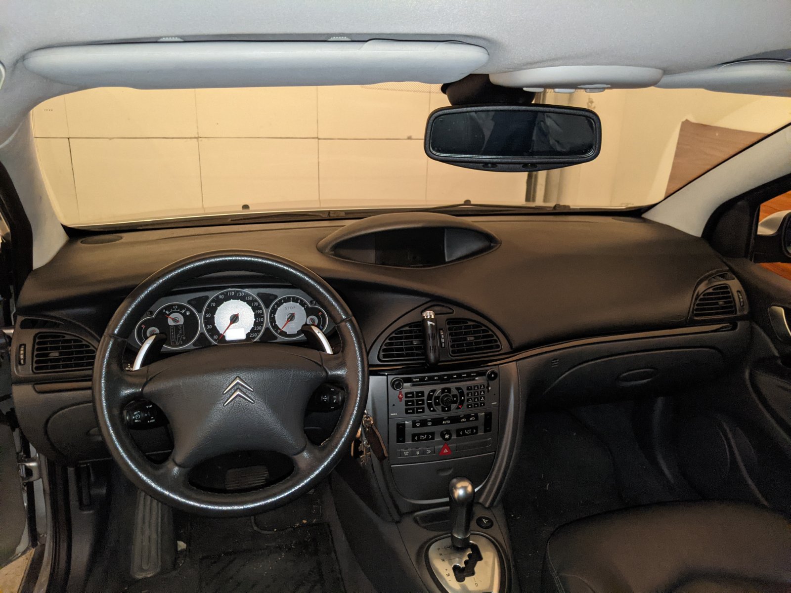

Hi i'm new to this forum and I thought i'd share my attempt at fitting the flappy padles on my C5 mk1 restyling.
It's actually easier than it may seem.
Of the 6 wires on the connector at the base of gear stick 2wires controll the PARK lock mechanism the other 4 are:
12V
LINE1
LINE2
GND
(I don't remember the color of the wires, i'll check and update)
LINE1 and LINE2 have a simple logic to controll DRIVE/MANUAL and gear changes like this:
(LINE1 - HIGH,LINE2 - HIGH) gearbox in DRIVE
(LINE1 - LOW,LINE2 - LOW) gearbox in MANUAL
(LINE1 - HIGH,LINE2 - LOW) shift UP
(LINE1 - LOW,LINE2 - HIGH) shift DOWN
Basicaly when the lever is in MANUAL position the LINEs are being pulled low and the switches on the padles need to pull either LINE1 or LINE2 HIGH to shift up or down.
LOW level neds to be below 2Volts
HIGH level neds to be above 3.3Volts
voltage on LINE1 and LINE2 should not go higher than 5Volts as it might damage the gearbox ECU.
