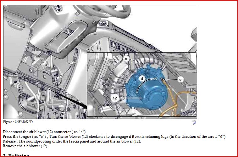

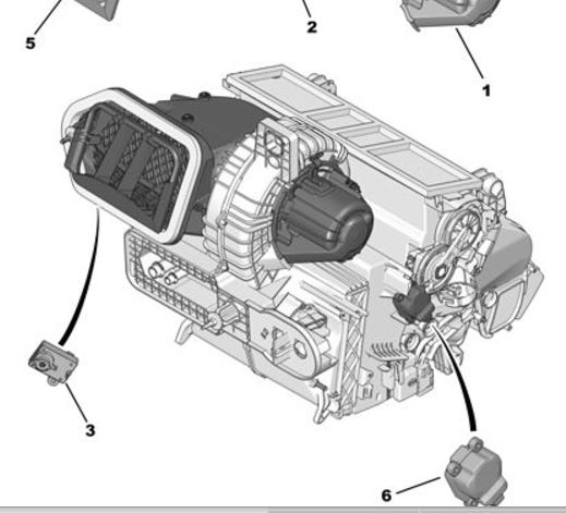

This pic is from the front, ie the blower is on the LH side of the car:
This is from the procedure; it shows a LHD car, but suggests it is accessible from the footwell, although may be easier through the glove box on a RHD.
