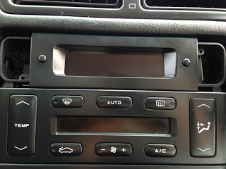

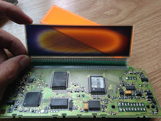

You have to find Polarization film. Then, start to repair,
by removing the polarization film on both size of you MFD.
Then cutting "one" of your polarization film according to the size of you MFD .

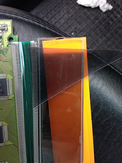

Stick that one behind the display glass. Then, the front one you have to turn it 45 degree. and cutting it.
The following show the wrong angle.
This one show that the front film has the different angle with the one behind. (45 degree)
Slowly remove the plastic and stick the film to the front of MFD display.

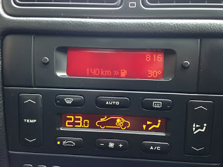

That's an excellent "how to". Where did you get your polarising filter film? I appreciate that you're in Thailand but was it easy to get hold of?
