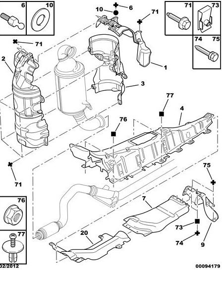

For your C5, here's the Heat Shield setup - mine and the OP's will be different as they are X7s. I never had an issue on my Mark II TBH. This is for the saloon, but take your pick! :-D

Re: 2009 Citroen C5 vibrates on Acceleration.
Unread post by MikeT »
Mine (estate) is slightly different but no4 and no20 look likely suspects. Thanks

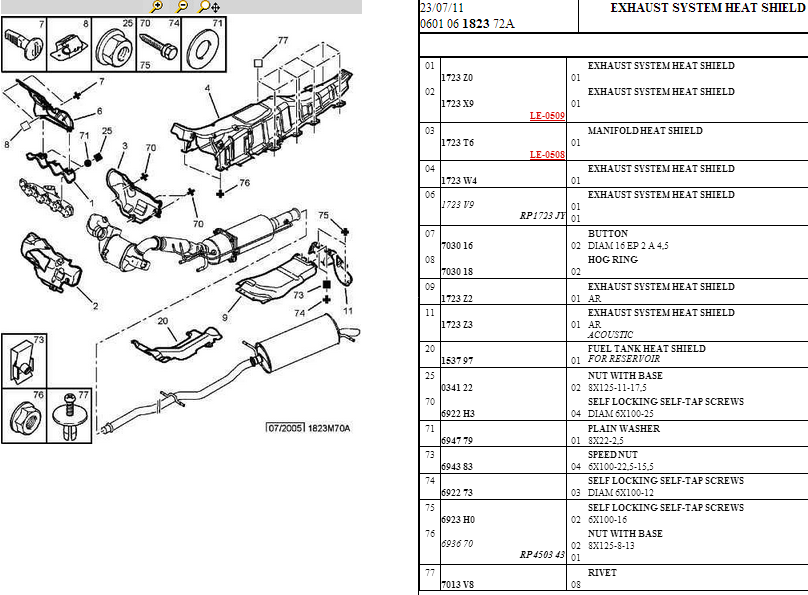

Is yours 1.6 110 (DV6TED4) with or without the DPF Mike?

I'm going by the picture citroen service shows for C5 MkII 1.6hdi 110hp with DPF which gives this
x 6957
That's fine - I was going to post it up, but no need now :wink:
