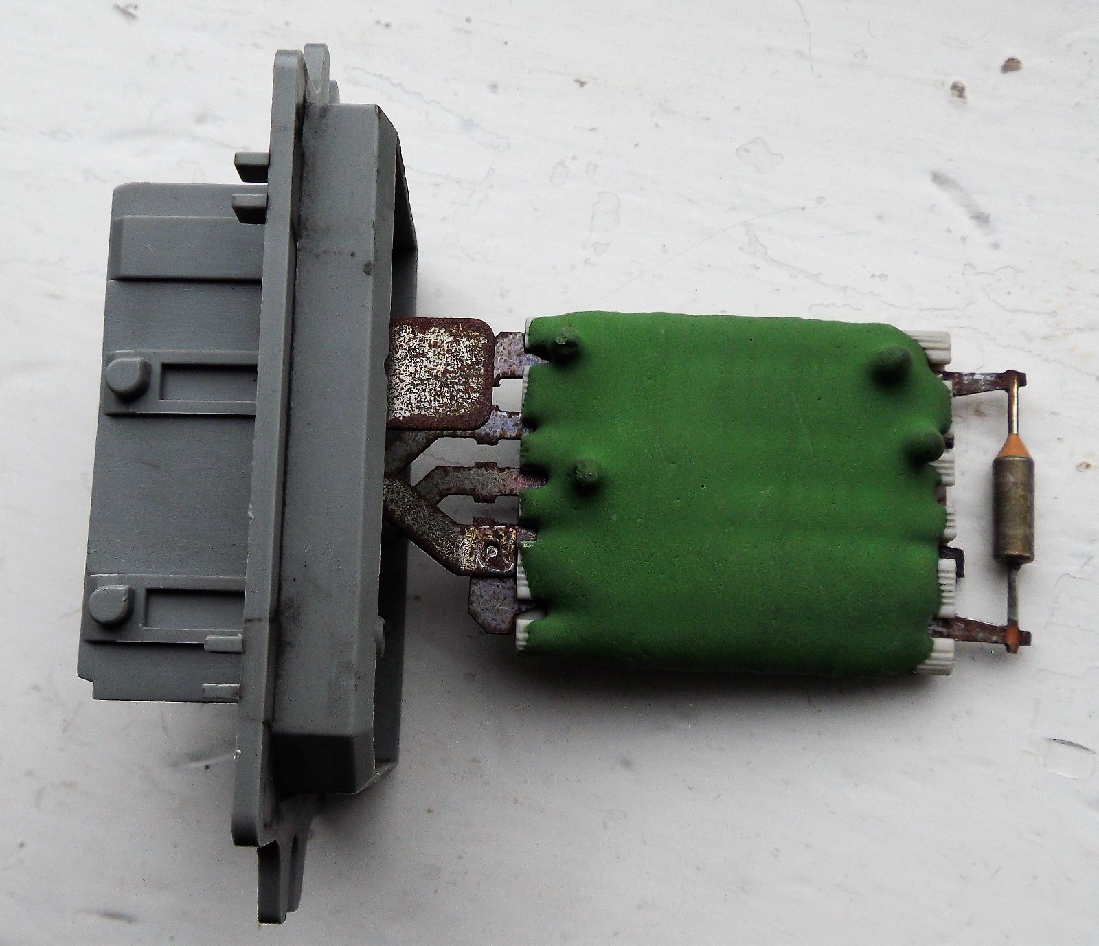

I'm still stuck on this, nobody seems to have the right part or a later part with mod. There's a used one on Ebay from Lithuania that looks as though it's been buried in a pit for a long time.
This is the offending part.

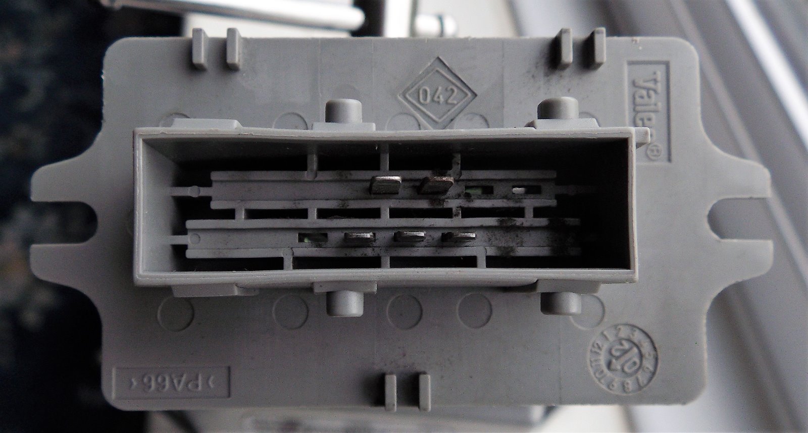

- x 2941
Re: Part number look up, please.
Almost Steve but the connections are different.
