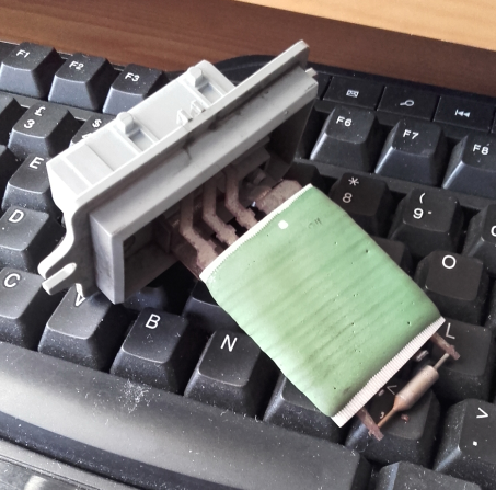

I'm not to keen on cutting the loom and fitting a replacement. Here is a photo of the one I have taken out.

Having thought about this, cutting the connector off and fitting a replacement seem doable.
I have found this one online http://www.eurocarcare.net/heater-contr ... uator.html
Any comments before I buy it ?

Hi Paul, Everything looks in good condition and no sign of any burn out. The fault I hav is that fan speeds 1 and 2 don't work.
I have a meter and wondered if I could test it somehow?

I have continuety over the ends of the thermal fuse - does this mean it is faulty ?
A house fuse looses continuity if it blows so I am a bit confused.

If the thermal fuse is bust then you won't have anything so it must be OK. One of the pins looks like earth, the others are connected to it via a resistor. You should have continuity between any two pins if all the resistors are OK.

kayjas wrote:I have continuety over the ends of the thermal fuse - does this mean it is faulty ?
If that thing is as I imagine it will be a 'ladder' network and although you have continuity it may be through the resistors rather than the thermal fuse.
Ideally each component should be disconnected - at least at one end, and measured - otherwise the test current will run through the remainder of the network.
The thermal fuses can be a problem to replace/reattach as a soldering iron will blow the link, they need to be crimped on unless you can isolate them from the heat.

In the photo of the kit on the QER web site they do include two crimpable tubes.myglaren wrote: The thermal fuses can be a problem to replace/reattach as a soldering iron will blow the link, they need to be crimped on unless you can isolate them from the heat.
