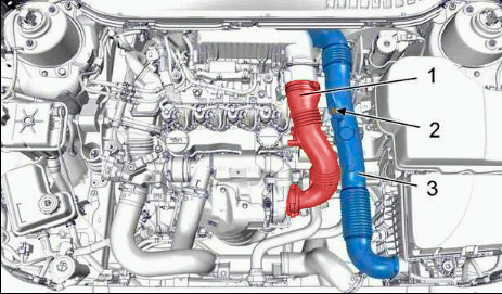

2) Remove the Bolt (2), the Air Hoses (3) & (1)
Removing Air Hoses
Removing Air Hoses

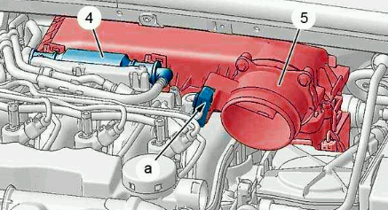

3) Unclip and move aside the manual priming pump (4). Disconnect the connector at (a), then raise and move aside the Air Filter Housing (5)
Moving Air Filter and Manual Primer

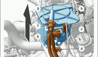

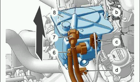

4) Unclip the connector at (c), Clean the unions (6) & (7) with some degreaser (SODIMAC), then uncouple the connectors (6) & (7).
5) Plug the openings of the unions and the pipes with the Plug Kit
6) Unclip and lift the fuel filter at (b). Disconnect the connector at (d), uncouple the fuel bleed pipe and remove the fuel filter (8) following the arrows.

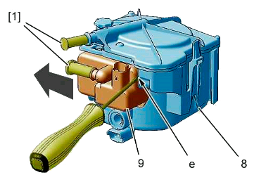

7) Insert a screwdriver at (e), remove the fuel heater (9) following the arrow.
8) Refit the fuel heater (9) onto the the new fuel filter. Couple the fuel bleed pipe to the fuel filter.

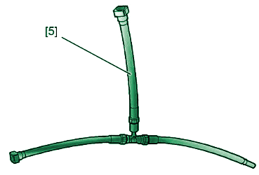

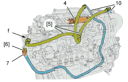

14) Connect the female unions (10mm Diameter) of the Union Bleeding Tool in place of the Union (7) at (f).

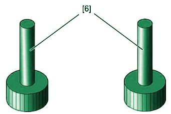

15) Close the union (7) using the click fit union tool kit (6). Clean the unions (10) using a brush and the degreaser (SODIMAC).
16) Uncouple the fuel return unions (10) and insert the union (8mm Diameter) of the union bleeding tool (5) in the fuel return circuit.
