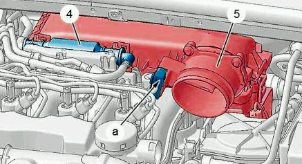

Ok, so you have the 110 DV6TED4 engine. Now I'm not suggesting you have all these tools - but I am listing what the official procedure is, so that you know what is 'supposed' to be done and if there is anything you have missed, this may explain the issues you are having as ekjdm14 has explained and it is likely that there is air in the system.
Note this is for the C5 X7 1.6 DV6TED4 Engine Specifically

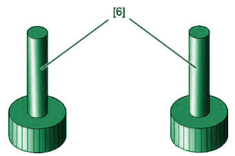

This is the Plug Kit (0188T) This is the Union tool for bleeding the Diesel Filter These are the plugs for the click fit unions 1) Disconnect the Battery & remove the engine cover

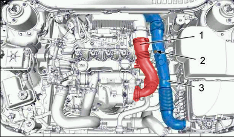

2) Remove the Bolt (2), the Air Hoses (3) & (1) 3) Unclip and move aside the manual priming pump (4). Disconnect the connector at (a), then raise and move aside the Air Filter Housing (5) 4) Unclip the connector at (c), Clean the unions (6) & (7) with some degreaser (SODIMAC), then uncouple the connectors (6) & (7).
5) Plug the openings of the unions and the pipes with the Plug Kit

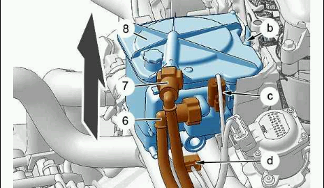

6) Unclip and lift the fuel filter at (b). Disconnect the connector at (d), uncouple the fuel bleed pipe and remove the fuel filter (8) following the arrows. (Note - the Fuel Filter cannot be dismantled. Change the complete fuel filter).

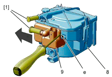

7) Insert a screwdriver at (e), remove the fuel heater (9) following the arrow.
8) Refit the fuel heater (9) onto the the new fuel filter. Couple the fuel bleed pipe to the fuel filter.

10) Fit: The The fuel filter(8). Remove the Plugs from the plugging kit and couple the union (6_.
11) Connect the connector at (c), refit the air filter housing (5) and connect the connector at (a). 12) Refit the manual priming pump (4)

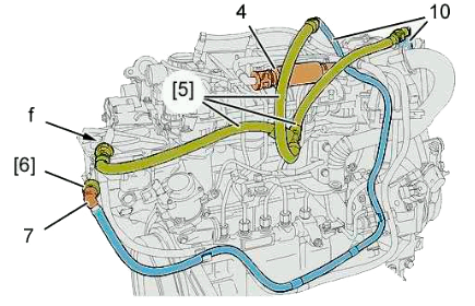

Bleeding the Fuel Filter
Purge After Replacement

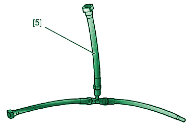

14) Connect the female unions (10mm Diameter) of the Union Bleeding Tool in place of the Union (7) at (f).
15) Close the union (7) using the click fit union tool kit (6). Clean the unions (10) using a brush and the degreaser (SODIMAC).

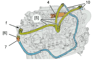

16) Uncouple the fuel return unions (10) and insert the union (8mm Diameter) of the union bleeding tool (5) in the fuel return circuit.
17) Operate the manual priming pump (4) for 2 minutes to prime the fuel circuit.
18) Remove the Union Bleeding Tool (5) and the Union Click Fit Tools (6) from the Union (7).
19) Recouple unions (7) & (10).
20) Operate the manual priming pump (4) several times to prime the fuel circuit.
21) Action the Starter and the manual priming pump until the engine starts (obviously you will need another person to assist).
