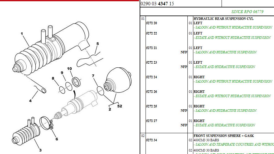

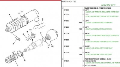

Hi, my S1 Xantia has a leak on the rear suspension cylinder . The rubber boot has perished .... now leaking from the cylinder ! Anyone know where I can get any spare parts ? is it citroen only ? many thanks in advance Terry.

I think you're probably looking at a used unit or a repair from someone like pleides.

Yes..... is saturday morning ok ? and how much would you like for it ? If your R P number is after 06779 . then the seals are available ! mine is before

R reg standard Non-HyActive.....should be OK.
