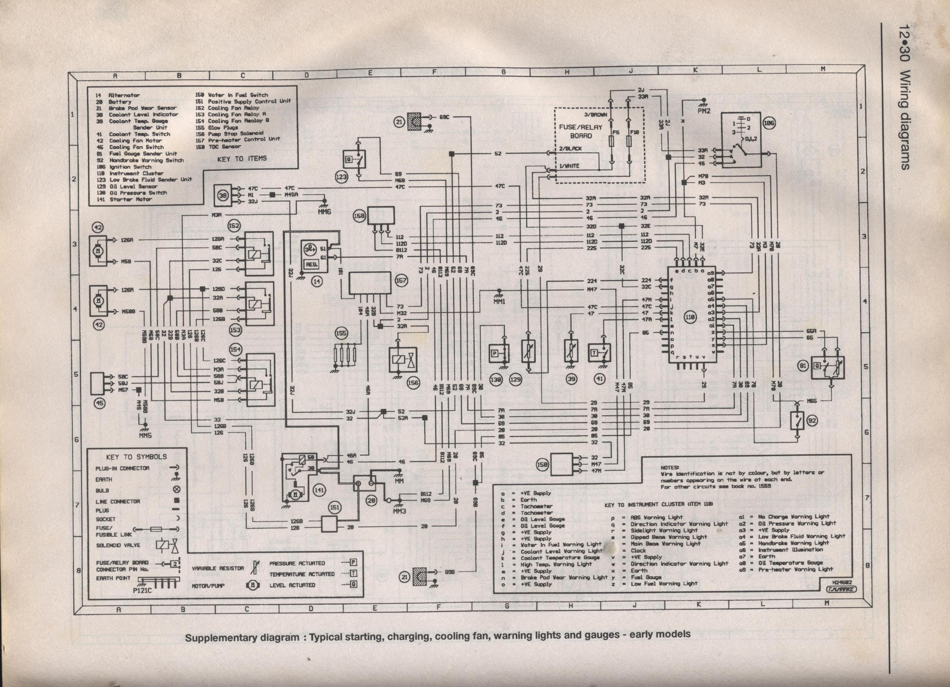

Hopefully someone can follow up with a circuit diagram.

Attached is the wiring diag from the BoL, 405D, OWM 3198, but I could do with some help working out how to read it. I've always regarded such things as a bit of a 'black art' but it looks like its about time I de-mystified such things!

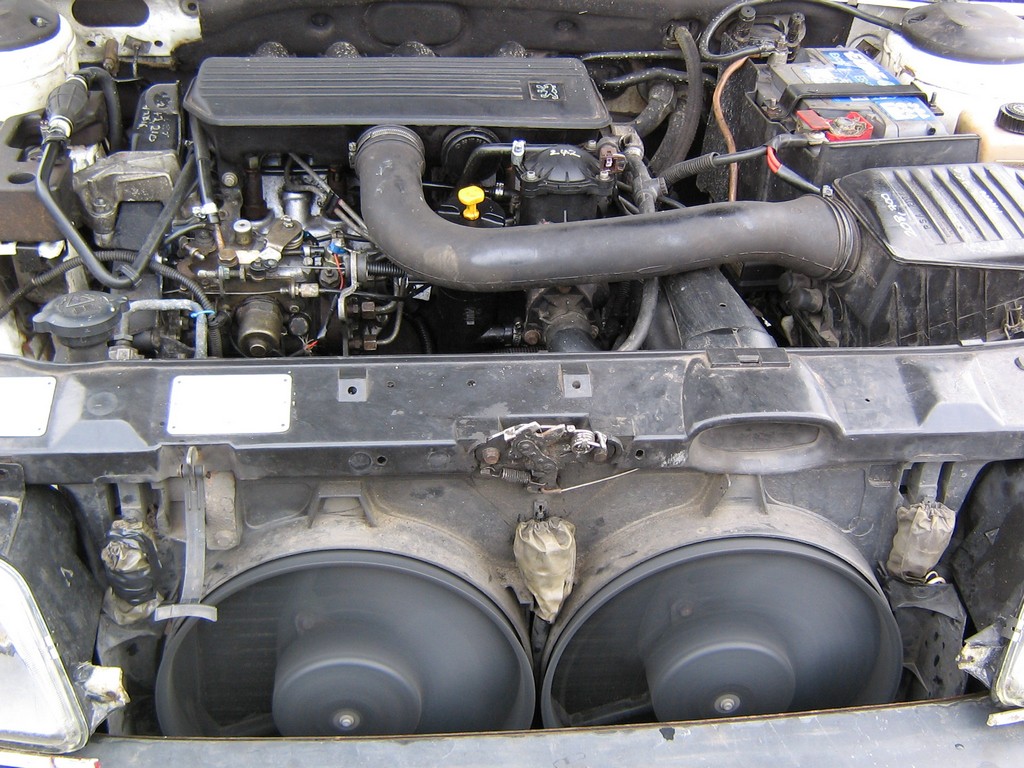

Mine's a twin fan with 3 Relays: just looked back through the 'Accident' photos of 2014, fan wise, both panels were identical, surprising really as the donor car which provided the new front panel was non-AC (I'd previously thought that non-AC cars were single fan), hence it was impossible to refit the condenser due to a central mullion being in the way of doing so.

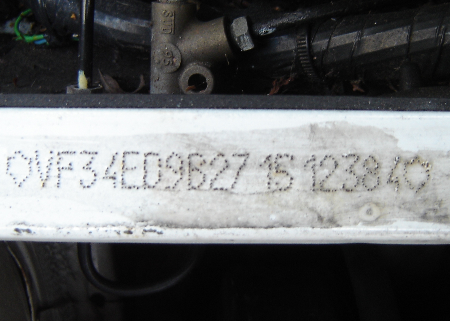

If you can post your VIN number, I'm sure someone will be able to help with a possibly more helpful diagram.

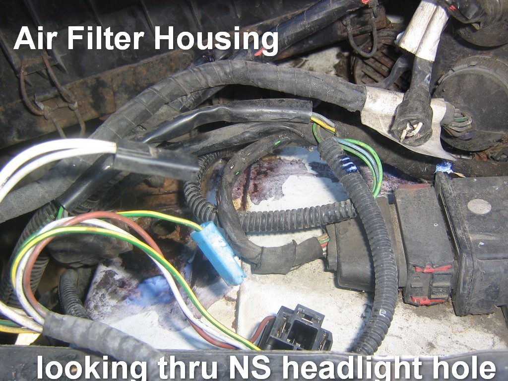

Down front, you should find a row of these three relays, 1" cube jobbies, usually black. Sited here, they suffer from wet and contact corrosion. Unplug each one (they are identical relays) and clean up the external blade contacts back to bright metal, and try to clean the relay socket contacts as well. A small piece of thin glass-paper, emery paper, or a thin nail file/board, plus some contact cleaner, will help.
If you're feeling confident, you can open up the relays (ping the outer plastic case off) and check the contacts are clean/not burnt. They're each a standard automotive 12v 30/40A changeover relay, readily available. If these three interconnected relays do not function properly, fan mayhem usually results. Your fault may lie elsewhere though, but worth eliminating these.

My vehicle VIN is VF3**************[VIN obfuscated, can be read by forum staff]
Date of first reg'n Dec 1995 on an 'N'
Panel vehicle VIN is VF3**************[VIN obfuscated, can be read by forum staff], reg L792 GJO, scrapped 2014
Am familiar with the location of the relays and certainly the right time of year for damp issues (which was the cause of the NS Horn having packing up, changed while doing the headlights recently). Think I'll pass on opening 'em up, coz I must have a spare set anyway from the old accident damaged panel.

NB1: anyone know how the connection comes out of the bottom of the Relays? They look dry but I haven't been able to check em properly as its far from obvious how to unplug 'em. As yet, I've not dug out my spares, which are probably in the loft.

The fan relays are each 5-pin, and are usually plugged into a 5-pin relay socket, from which the four (or five) cables take off. If the relays pins/blades get corroded, it can be difficult to unplug the relay from the socket. Give the small gap between relay and socket a generous squirt of WD40 (or better, contact cleaner) let it work in, and lever the relay and socket apart, evenly on all four sides. It should reconnect much, much easier!

I've just taken another look at your excellent "turbo propelled" photo . . . Enough gust there to drive the car!
If those are the three relays, in their plastic bags, what an awful location for them - guaranteed to get the full dose of weather, spray, salt... and bagged up to keep the moisture there! On XM, the same three are lined up together, tucked under the front slam panel: still not a great place, but at least they get the heat from the engine to dry them out afterwards! (They're can corrode on XM, too.)

yes indeed, and as cars go it's light, about 1100Kg, Location really could be better couldn't it, grille removed of course, but nonetheless.....
do you think we can put that one down the bean counters, whom were no doubt keen to minimise the amount of wire involved? Its chunky stuff to these

Ugh plastic bags round electrics... The first "mod" my dad made to his 309 on purchase, was to cut the water filled sandwich wrapper off the distributor cap...
