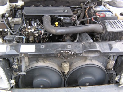

looks like its turned out a simple one in the end, traced it to dirty connections on the Sender atop the stat housing, did take a close up photo of the very un-pretty state the pins were in, but blurred so useless. Another of those occasions where I was glad of me little model-maker's miniature rotary wire brush (at £1 ish for 10 or so, they're worth having in the toolbox and last better in use than you might expect).
Seems that the system to the fans is designed to 'fail-safe' if the sender fails. I took this pic of the fans running on fast having removed the feed to the sender (you can see it atop the fuel filter, its brown) and turned the ignition on.
Simples! Makes a change! :-D

I've just taken another look at your excellent "turbo propelled" photo . . . Enough gust there to drive the car!
If those are the three relays, in their plastic bags, what an awful location for them - guaranteed to get the full dose of weather, spray, salt... and bagged up to keep the moisture there! :cry: On XM, the same three are lined up together, tucked under the front slam panel: still not a great place, but at least they get the heat from the engine to dry them out afterwards! (They're can corrode on XM, too.)

yes indeed, and as cars go it's light, about 1100Kg, Location really could be better couldn't it, grille removed of course, but nonetheless.....
do you think we can put that one down the bean counters, whom were no doubt keen to minimise the amount of wire involved? Its chunky stuff to these
