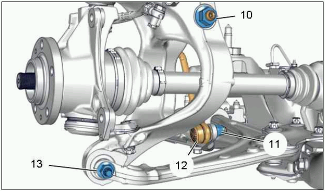

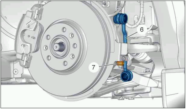

So this is from the Removing - Refitting Front Pivot doc, - is it this or something else? and this:RichardW wrote:Doesn't seem to be anything about it Marc - in the removal of the cylinder procedure it just says remove the link!
