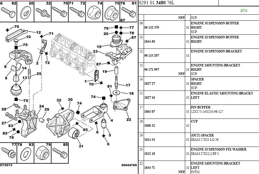

I am changing my top engine mounts on 1996 1.9 td xantia i removed the old one which was showing signs of perishing ordered new ones. However the new onecame without a spacer whereas the old one had one i can put the old spacer on the new one but seems to lift up the rubber guides to high wondering wether it should have a spacer in the first place. Has anyone got an exploded view of components for right hand mount for the 1.9 td ?..

Thank you so much for that stickyfinger it has shown me what i needed definitely a spacer there number 14. The bizarre thing is looking at item 13 when mine was removed it was upside down which would hopefully explain the movement on pulling away but i cannot understand how this would have come about. If anyone has a xantia that they could try and get a photo of the mounting in place i would really appreciate it
