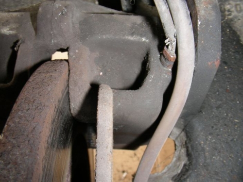

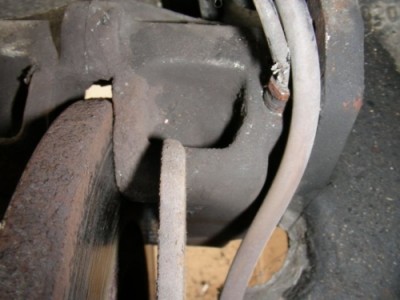

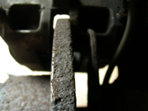

The first thing to do is to find out whether the problem is with front of rear brakes. Your problem could easily be the old 'rear calliper corrosion' problem where corrosion between the steel suspension arm and the alloy cylinder forces them apart until the disc is scraping against the calliper body.

This is what the view from above should look like (with new disc and cleaned up calliper)
