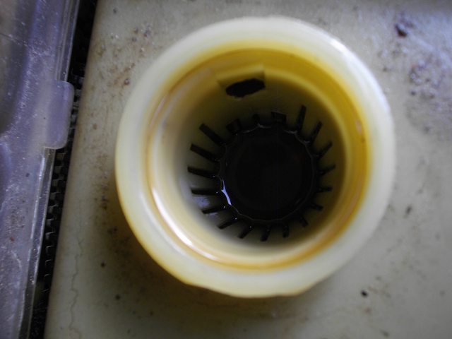

The way to check the level (and to fill the tank, if required) is with the car bottomed out. Take the cap off (yes, it is normal for there to be a little bit of pressure), and then take a look. Ideally there should be LDS between the upper and lower markers (I have attached a photo, to illustrate). If there is not you will need to add some more.

Thanks Hell Razor5543,
I didn't know the suspension had to be set to low to fill the tank. I'll have a careful look under the car in the morning before I set off, just hoping there is no leaks. The odd noise from the pump is perhaps it priming when the level is low. Despite putting a litre in there appears to be nothing in the tank.
