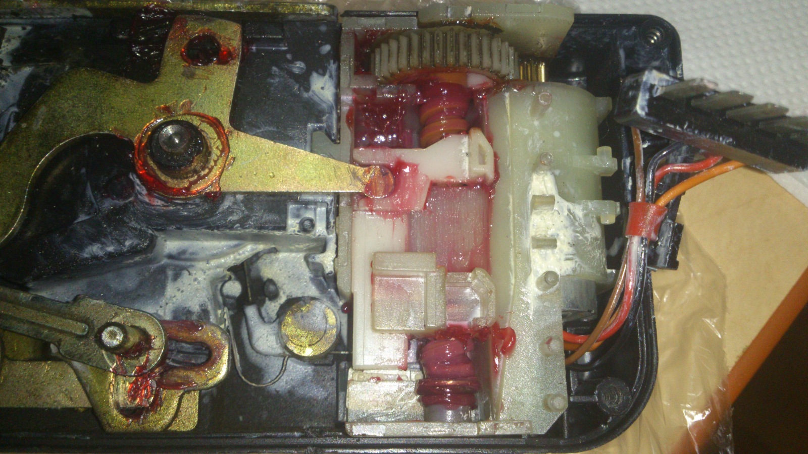

At Xantia mk2 the front door mechanism contains two switches, one is for courtesy light and one is for detection if the door is completely closed.
Like CitroJim said you have to drill out a rivet...if I remember correctly is just one rivet.
In the picture below is the mechanism from rear door...it contains only one switch for courtesy light.

It's great to see a picture of this
Thanks for posting it XF1!

Thanks for that image xf1ref. I've wiggled the door pillar to door wiring but no difference. The light works when opened with the remote fob, just not with the door only. So I will need to delve further.

I'm guessing that remote fob will bring the unlock/lock motor into operation, while just opening the door will not, as the door handle "by-passes" the motor mechanism. So ??? courtesy light switch fault resides inside the motor unit.HDI wrote: The light works when opened with the remote fob, just not with the door only.

Re: Courtesy light door switches?
That is more than likely the issue. I have an aversion to removing trim though, so my motivation is low for sorting this!
