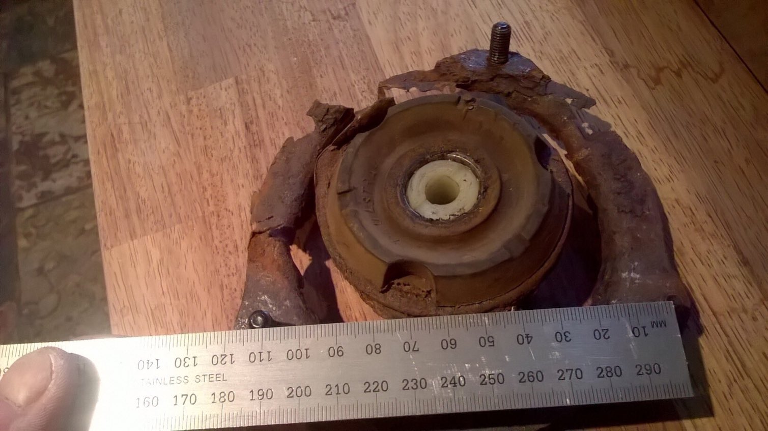

Hi guys. I'm really struggling to find the above for my pug. The old one has completely rusted away and replacements aren't listed anywhere.
Does anyone know a fix?
Appreciate any advice.

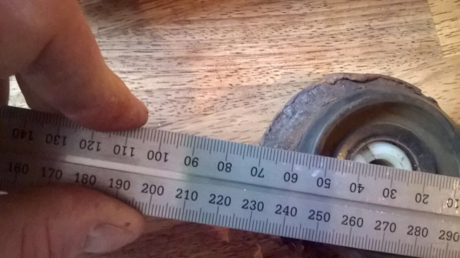

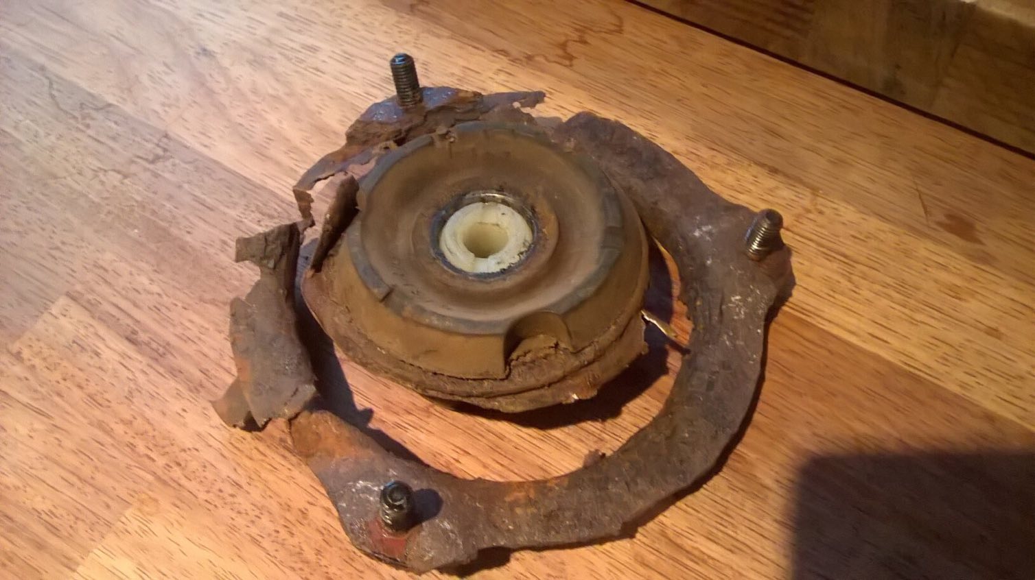

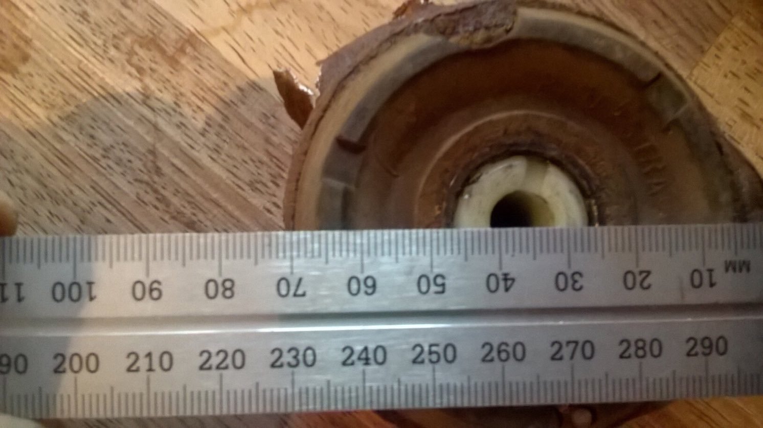

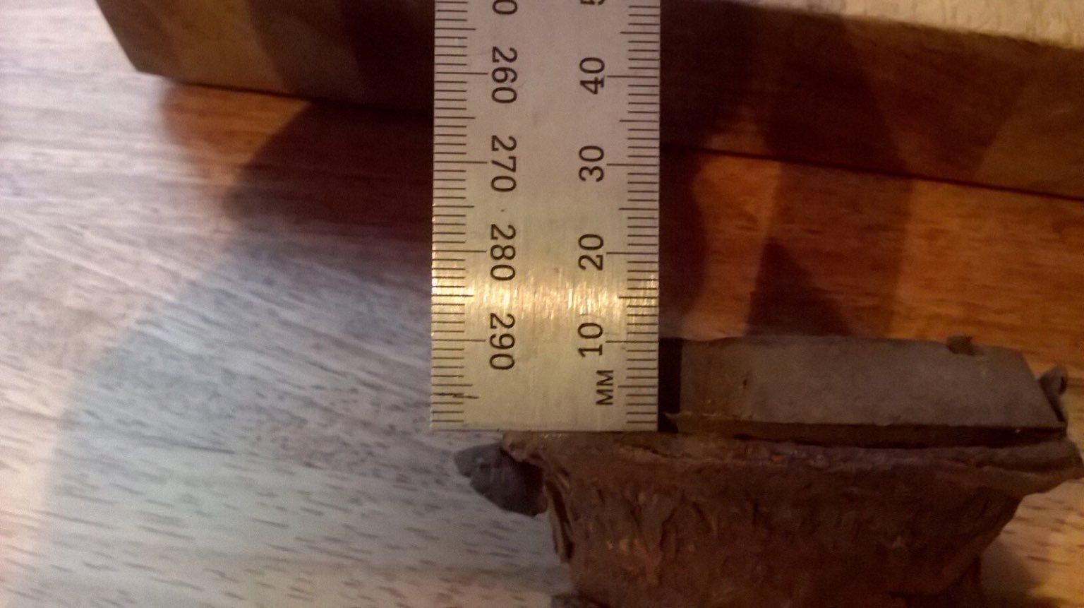

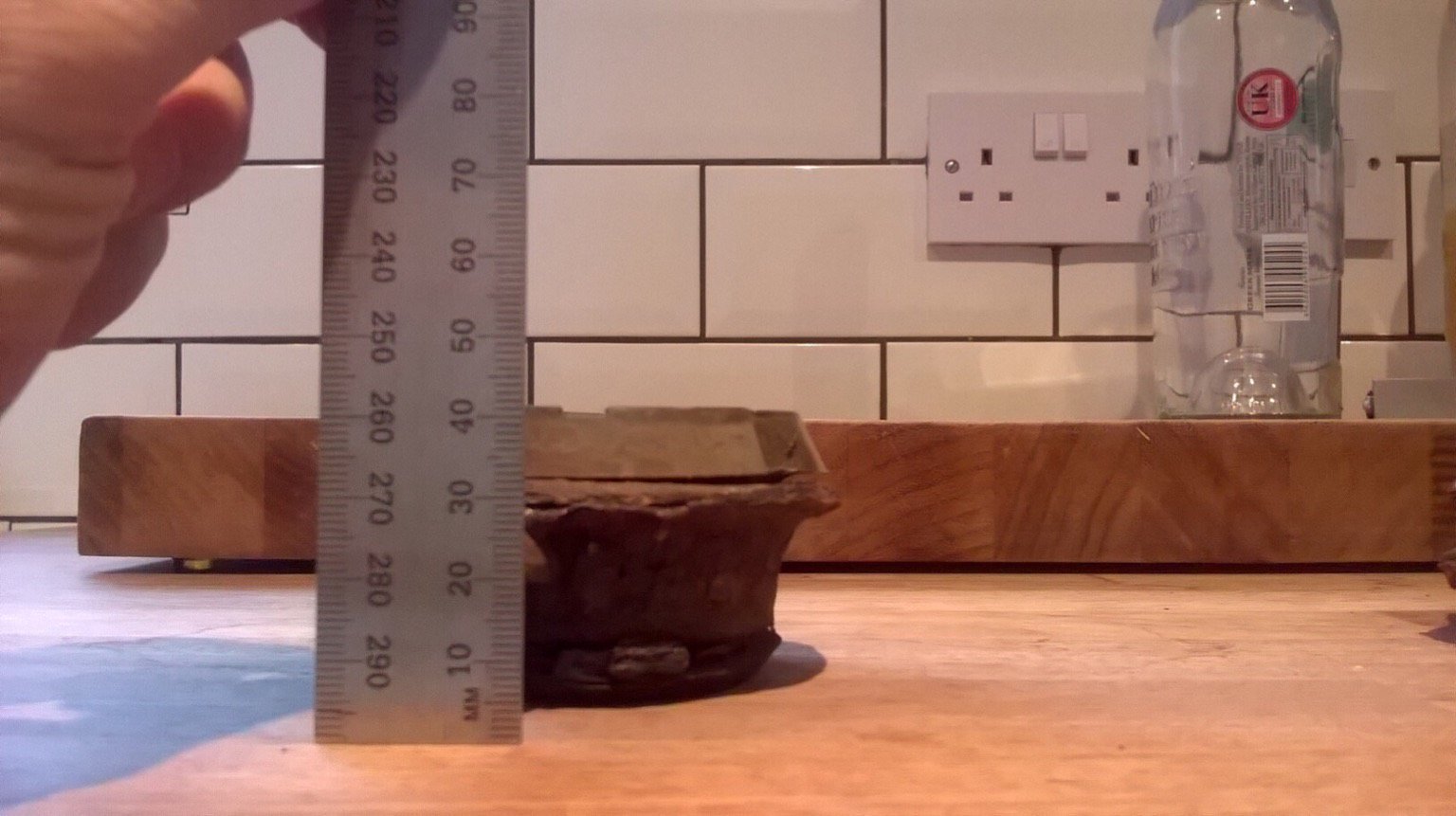

I have just emailed meyle with the dimensions to see if they have anything of a similar spec in their back catalogue. Let you know the results... here's some pics in case any of you know of an alternative that may be available for Citroen, Talbot etc...Aaronparke wrote:Hi guys. I'm really struggling to find the above for my pug. The old one has completely rusted away and replacements aren't listed anywhere.

ohhh....that is horrible.
