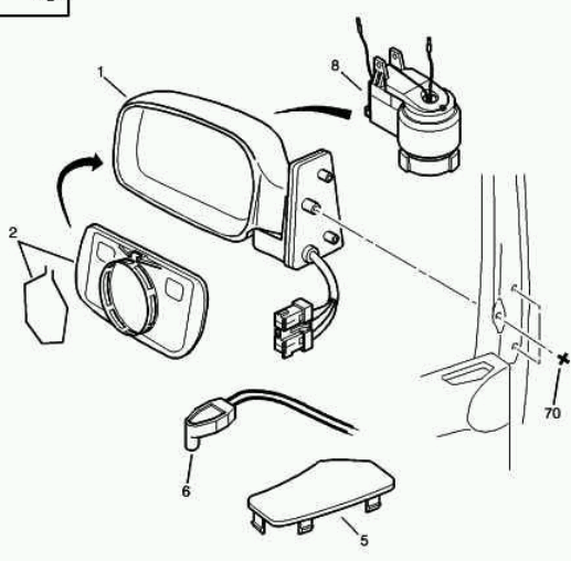

where is the temperature sensor , its suppose to be under the mirror there's nothing under the rhs mirror is under the left mirror ? how do replace it because its showing the wrong temperature ?

For a right hand drive, it is under the passenger mirror. It is a small nipple on the underside. Post you VIN if you want the part number.

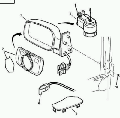

The part number for the exterior temp sensor is 6445 F9 (item 6 on the diagram) They are usually fitted on the inside of the mirror and the little nipple pokes out from the underside of the mirror housing. Unfortunately, there are no further diagrams showing the disassembly of the mirror.
