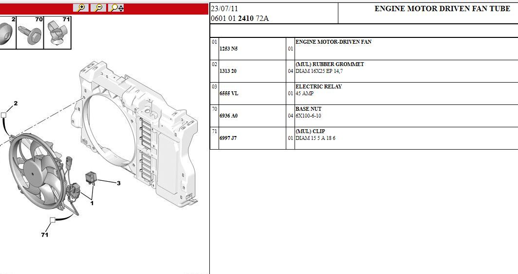

Had aa look at the thing tonight. Totally duff. Looks well rusted.
I had a look at the Polish guy's ebay page. Looks great. Garage not sure they have what I need. The numbers don't match but they say they may be okay. Not sure of parts number though. Could someone with the knowhow help with this? I'd be very grateful. Got my VIN VF7**************[VIN obfuscated, can be read by forum staff]
C'est pas possible!
- Posts: 11785
- Joined: 28 Mar 2013, 21:05
- x 1987
- Posts: 10912
- Joined: 09 Nov 2005, 22:03
- x 1438
Re: Urgent help needed
From Sticky's vendor above, 1253N5 seems to be there: http://www.ebay.co.uk/itm/RADIATOR-FAN- ... 2191982223
