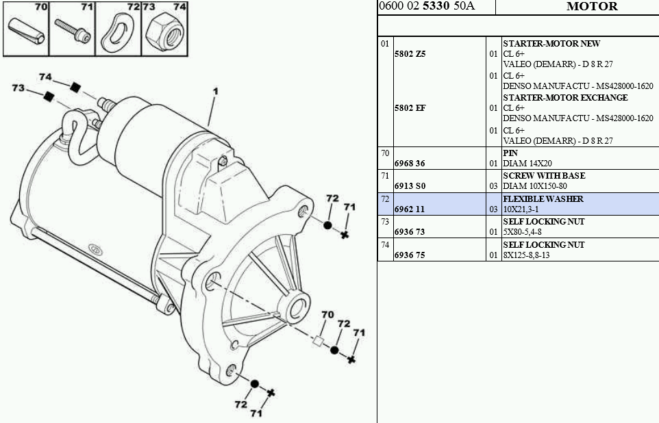

fotobright wrote:Thanks for all the helpful info. i'll get the starter out somehow and test. I'm currently 20 miles from my tools and workshop, which tools do i need? flathead and philips csrewdriver, hexsocket (what size), extension and ratchet. Have homestart so all part of the service. strike on of three though..
This might help - diagram is from a 2001 2.2 HDi Estate - although there are numerous makes of starter motor options fitted to the C5, there is only one diagram on fitting - so I guess the bolts are pretty much standard. The diagram gives the type and size of the nuts etc.:

Thanks for diagram, most helpful.
An update. I got the starter out and used jump leads from the battery and connector wire to see if it was operational. Initially just the pin popped out but perhaps because of wrong connector wire it popped out and then spun. Its difficult to tell if its a sticky motor but it was only 49.99 last year off ebay so may be a bit crap.
