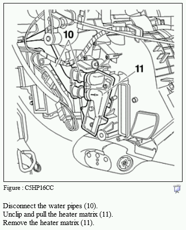

Re: C5 HDI 2L 2003 Internal Heater Core
Unread post by ozzdownunder »
Hi, I would like to know if there is any install/removal information of the internal heating condenser, the one where the water runs trough to heat the internal of the cabin. This is for a Citroen C5 2003 HDI sedan chassis nr VF7**************[VIN obfuscated, can be read by forum staff] . Regards, JM
ozzdownunder wrote:Hi, I would like to know if you stock a internal heating condenser, the one where the water runs trough to heat the internal of the cabin. It has a water inlet/outlet. If so do you have a picture and part number of this item. This is for a Citroen C5 2003 HDI sedan chassis nr VF7**************[VIN obfuscated, can be read by forum staff] . Price plus postage to Sydney Australia. Kind Regards. Hopefully you may have a diagram that you can send me showing how to remove and replace this part.
I think in your original post, you mentioned that you had managed to isolate the pipes, but wanted to know if there was a way to get to the Heater Matrix without removing the dash IIRC? If that's the case, I think you at least have to remove some part of the dash to get to the part (item 11 below):
Unfortunately, I only have the procedure to remove the dashboard. You may not need to follow all of it - but possibly the relevant bits to get to the matrix. If you want it as a PDF, send me a Proviate Message. I don't have a shortcut unfortunately.
The part for the Heater Matrix is 6448 J8 - An Australian dealer will be able to quote you a price I suspect. As Xantia V6 says, there's only so much we can do! :-D
