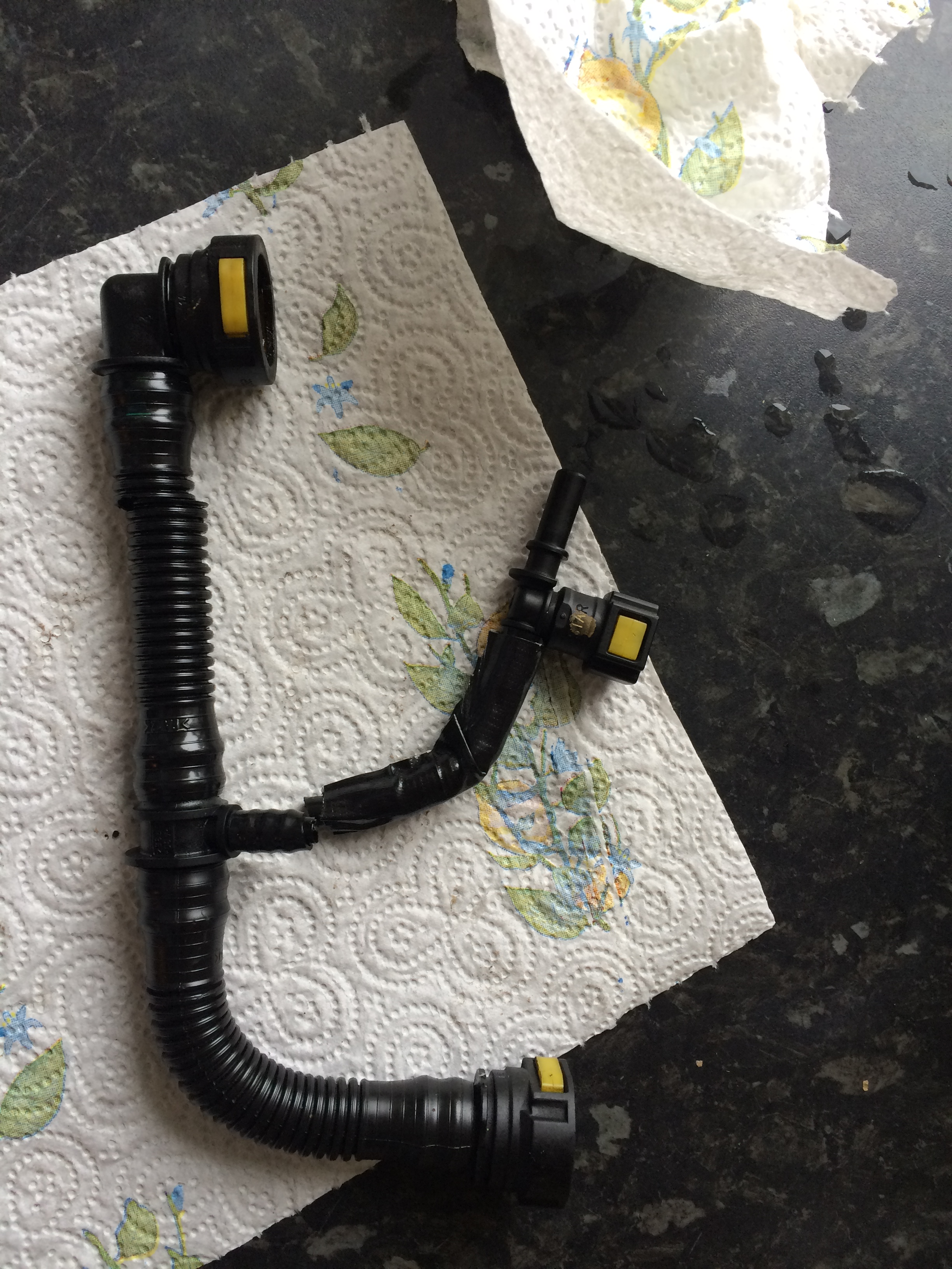

Ok, as I need to wait till pay day for a lexia/PP I decided to have a visual at the coil pack. Without even getting that far, there is a thin hose that has to be removed which has yellow clips on it. This was broken in a few places but taped together and the tape came loose. Any ideas what this pipe is called? I will post a pic once I've taped it together again to see if it helps then buy a new one(Hopeless with uploading pics though). Unsure what it's called.

Found that hose I think - is it under a cover connecting the rocker cover to the air filter box?If so, it's probably this one, but I'd need the last 8 digits of the VIN to confirm:
Reference Description Quantity Price - VAT Price + VAT Total + VAT Selection
00001192WZ OIL VAPOR HOSE 27.94 GBP 33.53 GBP 33.53 GBP
That would appear to be it - there are a few on e-bay, eg http://www.ebay.co.uk/itm/Genuine-Peuge ... xyOlhS1RBI
